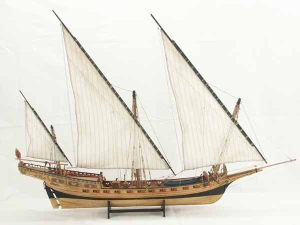

    A 1753 French made cebek type called Le Requim. It had 24 cannons and weighed around 260 tons. With triangular sails and a swoopy profile, it is a gorgeous ship. In 1:48 scale, it is 41" overall length.
    I realize that it will only be allowed 4 cannons, but it is just too pretty not to build. :)

    There just aren't many fore and aft rigged warships from the Napoleanic war era, but I think the scoop here is that they sail better to windward, easier to turn and what we're really after here is classic age of sail battles. I'd still like to see pics of that french ship, where are they?? It sounds like a cool ship.

    EDIT: Apparently, the file upload problem is only on the home computer ... works fine at work. Bleah.
    In the meantime, the best pictures of a model is the museum quality Le Requin in 1:48 scale located at www.bestscalemodels.com/LeRequin_shipmodel.html

    Fore and aft rigged ships tend to be much more maneuverable to make up for any penalty in armament. They should be able to sail much closer to the wind and generally have a sleeker hull shape to improve speed and maneuverability. Even with only four guns, you can run down other ships if you want, engage when you want, and generally control the battle. I could see that boat diving downwind to lure an opponent out of position, then sweeping back upwind to double-team another opponent.

    Its a nice ship for sure. I bought my plans from that company too, a russian 66.

    Finally sat down to study the plans tonight. There is a LOT of ribs ... so many that I had to decide which 10 ribs to leave out. It has a pretty wide beam for it's length, so should still be pretty stable.
    There is a major concern though that is giving me some doubts on whether to build the ship. The hull is very shallow ... enough that midships, the middle of the main deck is actually slightly below the scale waterline. It would not be a construction problem to build that deck. But for playability, there is practically nothing to shoot at in the middle half of the ship.
    Which kinda brings up another question. Is the hull above the main deck considered solid? Or should it be penetrable?
    Going to try to upload a picture again to show the outlines ...

    Personally, I would love to have the top decks represented in scale, not decked over as we do in the motorized combat hobby. Of course, on ships like LeRequin, that eliminates penetrable area above the waterline in some places. I definately think that holes put in abovedecks should count; putting cannonballs and grapeshot through the topside personnel was a good way to take out command personnel, marines, and not the least, the guys manning the top-deck cannon batteries. I propose that above deck holes should count as above-waterline hits. I would also propose that we allow a 1/8"high solid area along the top rail to glue the blasa above the main deck to (no floppy top end of the balsa, ja?)
    Another thought, Mike... are you going to have room to allow the cannons to move up and down to prevent cannon from becoming anti-aircraft weapons? With that sail plan and hull form, you are going to have to worry about heeling more than a bigger ship will. Aside from safety, it'll be hard to get in some of the magnificent shots that you otherwise might get from that maneuverability of the cool rig.
