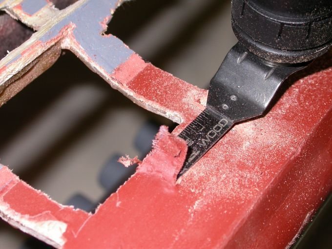

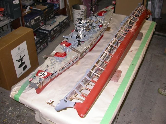

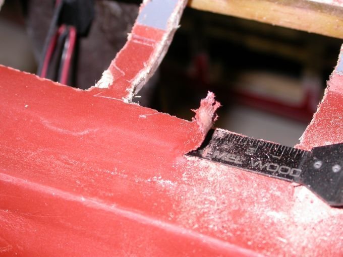

    Hey everyone. I started work again on Yamato and Bismarck refits. I used a MultiMax dremel to peel off the balsa but it is a very slow process so I used a good old chisel and went at Yamato. Just need to sand her hull clean with the MultiMax dremel and then I can start the new sheeting. I will be installing new foam channeling. I am going to use the pink foam this time. I seen how well it works on Missouri and it's easy to work with. After that the stuffing tubes will need to be relubed, gears greased, and I need to modify the servo platform. New Armor will be installed. Once done just need to install a new pump hold down and a new electrical harness for the batteries. The rest of the gear will be inspected such as the Co2 lines and valves and if I need to replace any I will. Think I will try the new Termite MAIN Turrets this time and add additional detail to them. I will also be building new Catapults and new planes. Give it a new paint job and we should be good.
    For Bismarck the hull needs to be sanded clean and the repairs to the main deck will commence. A new Main deck hatch will be made to support the new superstructrue and it's details. New Main Turrets will be installed. The old motor mount will be removed entirely and a new one will be built. I have a new servo platform dedicated for pump activation. It will have 2 Mag type switches to activate manually with a redundant switch and another switch will be float activated. The old superstructure will have some minor repair but it is staying as it is wearing the 19 years of battle damage including damage received from IRCWCC NATS 2010.

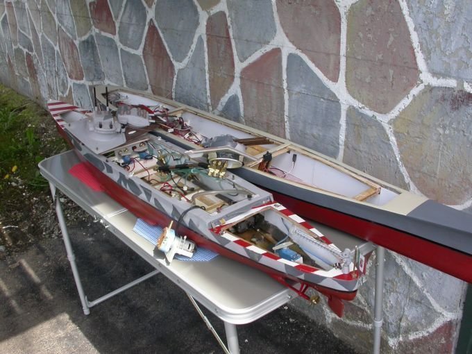

    MO and Roma drying out
