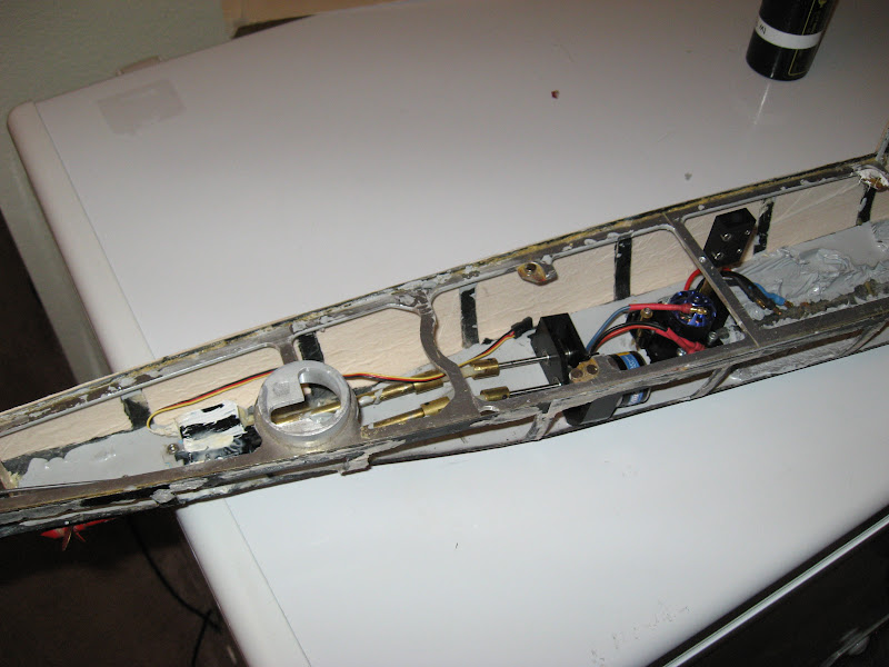

    see the picture below. These sections were made on my table top mill, hence the many short sections. If there are enough folks interested (and assuming it is cost effective enough, that I am not sure of) the sub deck can be cut in one piece rather than all the short sections shown below.

    I will have to draw up the line drawing and ask. that will happen when I get the hull to verify it fits.

    I had a friend of mine make the first one for me. it is not too bad but I would change a few things if I were to make it again.
    There should be some pictures in the baden build thread of mine, but I have some more pictures I need to post.

    check out the link here for some pictures. given my experience, I suspect that in 2-10 quantity a metal subdeck from a waterjet house would be on the order of 100$, possibly less.
