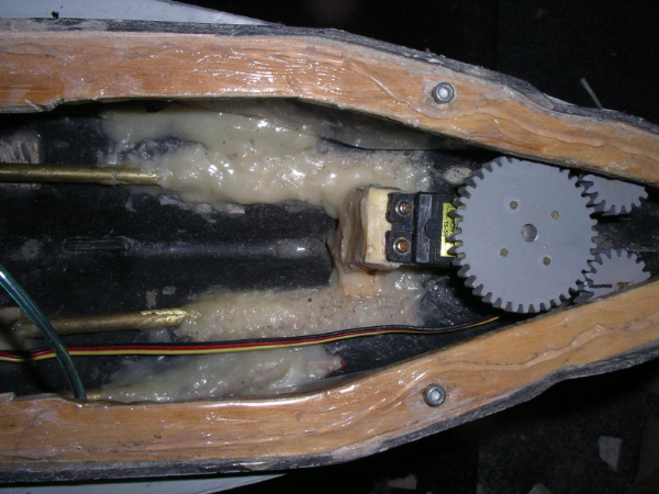

  10. SnipeHunter
    Rudders are controlled using a servo, either rotating a gear or by push rods. I'm not familiar with what comes in the BC hardware kit but I imagine it is designed for one of these two options. Here is a pic showing the servo and rudder gears for a VDT.
