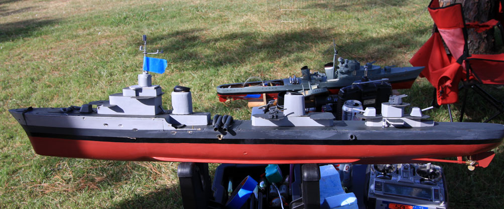

    (My Fantasque in the foreground, with Ben Lee's HMS Cossack in the back ground, at the North American Big Gun Open (NABGO), on July 12th of this year)
    Just a few musings from a hardcore Big Gun destroyer captain...
    Destroyers are challenging to build, engineer and campaign. In practical terms, they are the smallest combat warships, in terms of displacement, in either Fast Gun or Big Gun. They are not for rookies, either in terms of engineering or operation.
    Destroyers, by design, are long and slender, designed for speed. They are not very good in turn fights, as a rule, but if you can build a fast destoyer, you can use its speed to your advantage. I run a Fantasque, a member of the "Terrible" class of French "super destroyers." These were large destoyers (3' long in 1:144 scale), and the fastest destroyers ever built, even to this day (46 knots top speed). This class also carried mines and torpedoes. Mine currently has twin torpedoes mounted on each side, but I have tripple tubes waiting to be installed.
    Because destroyers have such small displacement, there are some very real challenges the captain must overcome in order to be successful. Some of these are:
    • Inherently unstable, which means that very part and piece has to be weigned and carefully placed for stability.
    • Very limited hull capacity for air and equipment, so they can't take much hull damage, and they are prone to sinking if the captian isn't extremely careful (and lucky).
    • Because space and weight allowances sre limited, there are few options for armament.
    • Also because space and weight allowances are limited, there are few options for batteries and motors. With those limitations, it's very difficult to get a destroyer such as the Fantasque up to its top speed, and to keep it there for any length of time. A slow destroyer is a sitting duck.
    • Because of the same space and weight limitations, every piece of onboard equipment must be miniature in size, which often means expensive, with limited choices. You may need to make your own pump, for example, and your guns or torpedoes may need to be custom built to fit in the hull.
    OK, so much for the challenges. Destroyers can be a lot of fun to build, engineer and campaign, if you can minimize the weight and "footprint" of the onboard equipment, and if you can keep the speed up, and if you can learn how to hit and run. A destroyer can be launched and retrieved with one hand, and can be shipped as luggage on an airliner. (The Fantasque in the photo was checked as luggage, to and from NABGO.) Destroyers don't need much storage or bench space, and they look pretty cool, too.

    very nice, what batteries do you use

    Thanks for the compliments! Both of the destroyers in the photo use loose-cell battery holders, with 6 AA NiMH 2700 mAh Lenmar batteries, for a total of 7.2 volts. Both destroyers run at around 37 knots with that setup, and will run at top speed for over 30 minutes.
    Ben and I have done a lot of experimenting with battery/motor pairings, looking for the perfect combination, and I believe Ben is satisfied with his setup, since the Cossak's top speed was around 37 knots. For my Fantasque, however, I'm still looking for sustained 46 knots. I have two new motors installed right now, and will be doing sea trials on Sunday, so we'll see.

    looks like she is armed only with torpedos.
    Have you come up with a way to arm the main batteries as well?

    I'm not certain whether or not your Mogador is Big Gun or Fast Gun, but a Mogador has about 10% more displacement than the Fantasque, and as I have quite a bit of lead for ballast, I'm thinking that, if you're careful, you should be able to arm the two forward guns in a Mogador, as well as arm torpedoes. It really depends upon how much overall weight you're carrying, and how it's distributed.
    Over the past few years, I've experimented and replaced larger, heavier equipment with smaller, lighter versions, in hopes of building up enough "ballast credit" to arm a gun or two. I have the credit now, but the big problem is space for increased gas supply and, in the case of a couple of bb guns, ammo, the guns, and plumbing. I'm not sure in my case that adding a couple of bb guns would be worth the effort, since the 1/4" torps carry a pretty nice punch.

    Rob, Very nice write up and ship!! Looks real nice. I see you have a PT boat under construction. Now thats a challange!!

    Thanks! I'm getting a little carried away with detailing on the destroyer, though, but I just wanted to spiff it up. You can't see Ben's Cossack too well in the background, but he's got very detailed ships, and at the same time, they're also very respectable combat boats. He's a true inspiration!

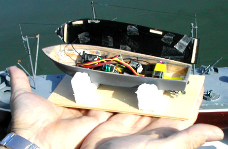

    The PT boat is sort of like the Holy Grail for 1:144 miniaturization fanatics. I've got it running and steerable, but there's a long way to go to make it capable of doing any damage.
