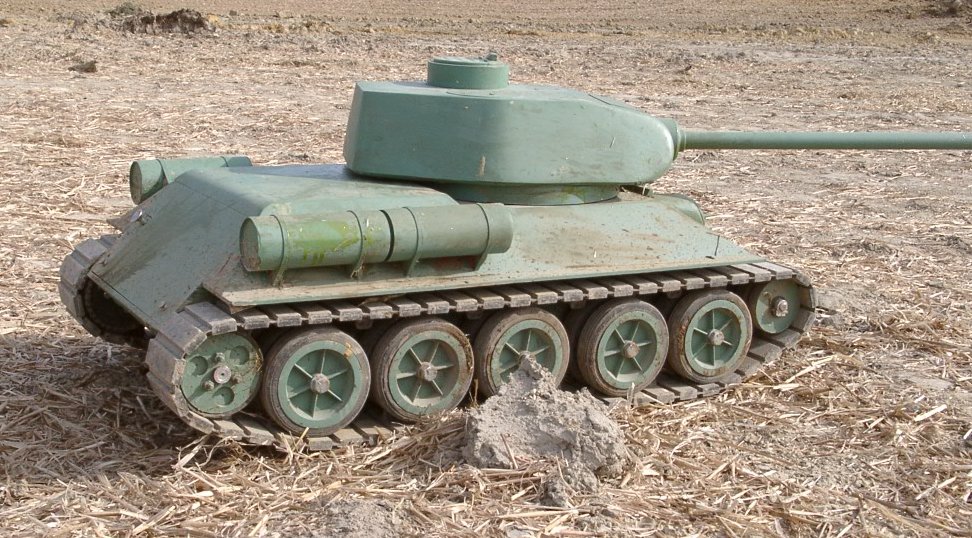

    My other hobby is RC Tank Combat. Instead of BB's they shoot paintballs. Read all about it at rctankcombat.com.
    One of my early tanks, the T34-85!
