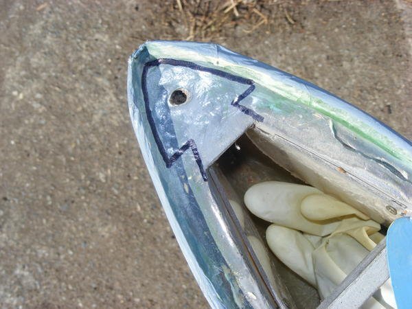

    im, sorta stuck again in my build, im up to putting the caprailing on, i just wanted to know how people bend the caprail around the top of the hull, at parts like the front where it goes to a piont and the rear where its a semicircle shape
    ive only glued in the cross sections that are striaght across the hull that separte the top and lower decks, so far the only solution ive come up with is cutting small blocks about 1cm long of my 12mm square dowl that ive routed out to hold the 3mm deck, sticking them on individually then sanding them to the same profile of the hull
    is there a way to bend it to the shape of the hull?
  9. DarrenScott
    Yes, there is a way, steaming. Soaking the timber in boiling water softens it, allowing you to bend it to shape. Use a thick ply base with the shape of the hull on it, and add screws as a jig. Soak the timber, and bend it around the screws. When it cools, it retains the shape. For the bow and stern, I use a key block shaped sort of like an arrowhead to hold the caprails.

    cool, thanks again Darren, but could you explane the key block thingo, i dont think i understand what you mean, perhaps some pics of the arrowhead arrangement may help
  12. DarrenScott
    I've outlined the "arowhead" fitted to my liberty.
  13. burnzy232
    burnzy232 Member
    Mar 8, 2010
    166
    aaah, i see, the cap rail fills in the space around the neck of the arrow head, ill give that a try on my hull see if it works, oh and thanks for the pic, very helpfull
