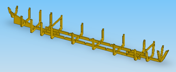

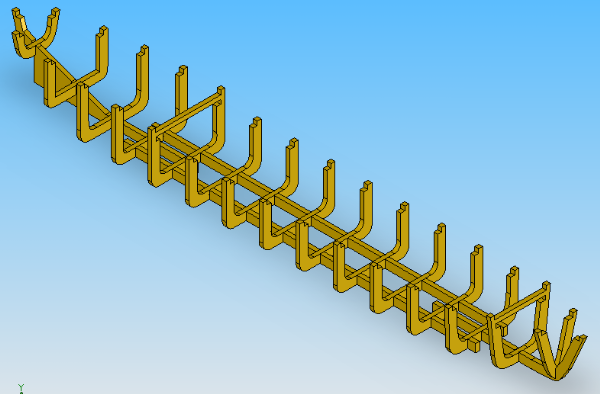

    So i decided to dust off my very rusty CAD experience. Found an old copy of solidworks that I had and decided to remodel the plans for the Mehoshi Maru. The primary reason for picking the Maru is because the original plan had 1 keel and I wanted to split that in to 2 parallel keels running most of the length of the ship .
    Isometric view

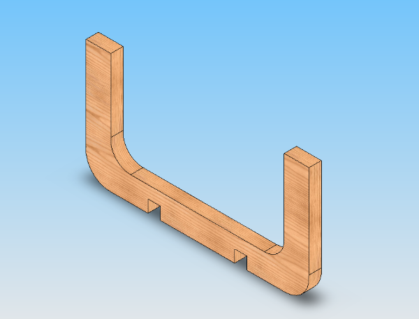

    You can see that frames 3 and 12 actually join with 3 keel pieces each. Each keel is intentionally half an inch longer on the joining ends to provide a full joint with the rib. The midsections of the ribs are also not removed (similar reasons, and it also keeps the part complexity lower)

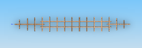

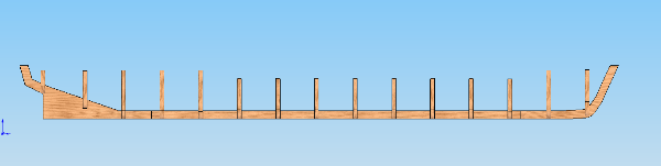

    This is looking directly down on the assembly

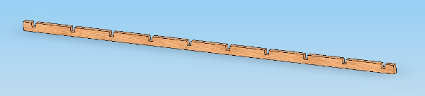

    The keels and ribs are notched to fit together

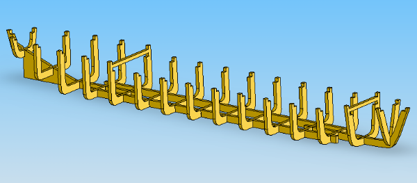

    From this view you can see one of the problems I need to address: Carl's plans aren't designed for jointing the subdeck into the tops of the ribs, rather theyre designed for the subdeck to be on top of the ribs - so my ribs are too short and need to be re-dimensioned before I can build the subdeck components. Thats ok though, because I didn't constain their heights properly originally and so with the exception of 4 - 10, they all have differing heights.
    I am concerned that the the aft keel is too thin - this is supposed to be a single screw, single rudder vessel, but the aft keel is only 1/4inch material - If you put a stuffing tube through that I'm a little concerned there wont be much left there...

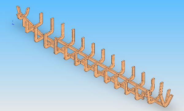

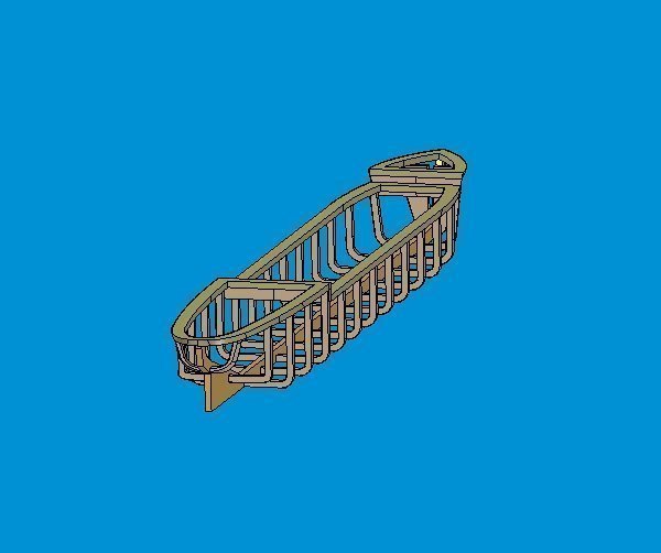

    This is an image of how Carl's CAD build (looks like ribs, keel and subdecks are complete here)
  2. rarena
    Wow that's some cool stuff. I might have gone one more rib in on the front and back sections just to give it a bit more strength.
  3. NickMyers
    I thought about that, but for the moment I'm just mostly replicating Carl's original rib layout. They're 1/4inch ribs, the mid-section ribs (about 3 - 13) are spaced 2 1/16 inches apart - the aft ribs have a little more spacing between them as-is. If I cram them in closer to fit another rib I might run afoul of the penetrability requirements. I'm already thinking the stern might violate them: from the tip of the stern to the aft-edge of the aft rib is only 1 1/4 inches, so 1inch of impenetrable stern material would leave only 1/4inch gap between impenetrable and rib - not sure of the legality of that - Maybe someone can enlighten me?
  4. rarena
    No, I mean to extend the front and rear sections longer to attach across two of your existing ribs down the centerline. It would keep these "module ends secured to the main frame better. Right now they only attach at one anchor point making them weak.
  5. NickMyers
    Ah, i see now. That might be a good plan. I was thinking that the cap rail/subdeck jointing in would lend sufficient strength to the assembly, but perhaps not.
  6. rarena
    The more you build on it, the stronger it gets. It probably would be fine but.....
  7. NickMyers
    Nothing to be lost by a little overengineering. I'll add your suggestion in with the next round of changes here. :) I can always cut off the extra if it proves to be in the way (but why would it, its a 3ft long unarmed cargo ship, space isnt exactly at a premium)

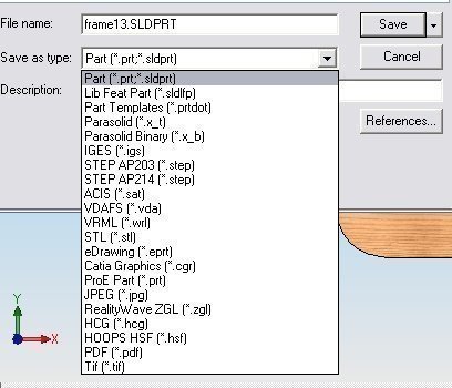

    What do you think of Solidworks and what sorts of files can it export. I'd love to be able to do some cad assisted designing but don't have any experience or cad tools at this point.
  9. NickMyers
    I like it, but my only modeling experience has been from Solidworks and later Maya (definately not for CAD, ugh). I am by no means a profesional though - about 5 years ago I took a quarter long class on CAD modeling with Solidworks and thats about it. Its definately not cheap - my copy is an old one that I gleaned off of a friend of a friend who no longer had a need for it - there's no way I could afford to throw the money at a new license for the latest versions. I think non educationals are around $4,000 per seat?
    Learning curve wise, I dont think it was that dificult, but I also had instruction and labs/course assignments, etc that I learnt from. There are books and tutorials available though.
    I'm honestly not sure of its export list, as I've never migrated a file out of it. This is the list of file types it can save as. I believe the newer versions support more as well, and there are plugins to more export options I think.

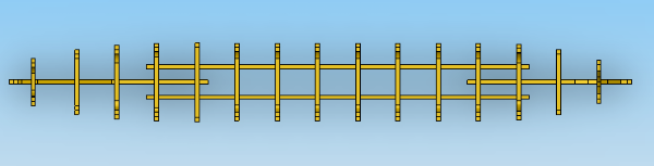

  12. NickMyers
    Update - Made some progress today. Redimensioned some of the aft ribs and fixed a error in the keel dimensions. Heightened and notched the tops of the ribs to accomodate a rail. Also took Iceman's suggestion and lengtened the bow and aft keels to extend one rib further in to provide additional support.
    Also ribs 2 and 11 have cross members now to fill the gap between the different deck levels.
    I'm pretty sure I need to use wider material for the aft keel though. Its 1/4inch right now and it seems that a stuffing tube is about 1/4inch OD. Oops.
