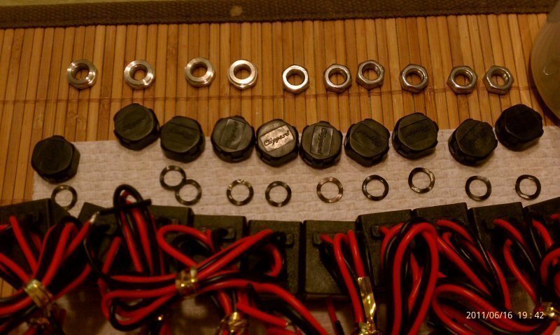

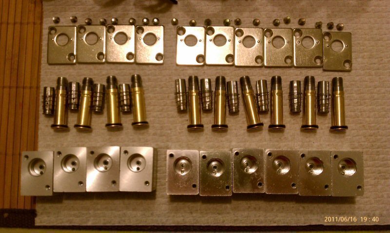

    Update, I just got 4 more valves in and disassembled them next to 6 older ones I already had. The old ones had a U19 code on the label, the newer ones had a C10 code.
    They appear to have made some improvements in manufacture recently. Machining quality on the valve body is slightly better.

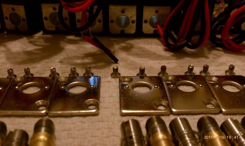

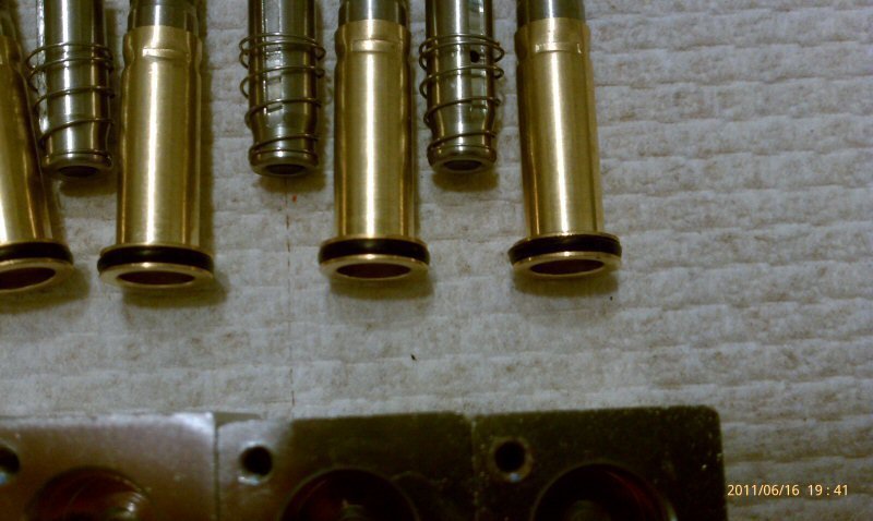

    One of the older ones (far right) had a pinched O-ring on the top seal. Don't know if it would have leaked. I can't take a really good closeup with my phone camera, sorry. Some of the valve stems on the older ones are missing a hole in the side, which I assume is an air bypass to allow the stem to travel faster. The seal has also changed shape slightly.
    Most importantly, they changed the screws. The older ones on the right were already rusting, new in box. They take a #1 phillips. The newer ones on the left appear to be stainless or nickel plated, and take a #2 phillips. Good call, Clippard!
    Same old wavy washers though. They usually rust away quickly. I'm not sure what they are for but a lot of solenoids have them. I've never noticed a difference between having them or not. The extra nuts at the top of the screen come with the solenoids, I assume they are spares for when the brass inserted plastic caps break or get lost. The newer ones are machined and have a better seating area. The older ones are just plain old nuts.
    Ron Hunt
