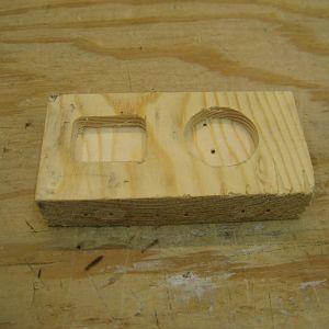

    I've been working on getting my shop setup and included in that is a CNC Mill build/conversion. (I imagine I'll get a 3D printer sooner or later but the CNC Mill was a lot higher priority, I'd rather have metal crap than plastic crap I guess...) I got the mill modified and working and sorted out the software tool chain so I figured I'd run a simple test.
    It's not much and the mill still needs a bit of adjusting, getting limits setup, and a few other random things but I'm pretty excited. Hopefully this will help me test out guns, gun mounts, pumps, impellers, motor mounts, etc.
