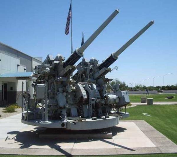

    I was wondering if anyone has built these guns from scratch. If so, how? I also added a photo of one below. Thanks for your comments and help.
    Jeremy

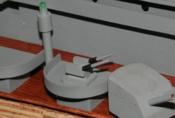

    Well guys after looking and messing around here is the scratch built Mark 33. Most of the gun is styrene (from local hobby store) and other parts as listed
    Gun barrels: Music Wire .078
    Spring on barrel: Hillman Spring #87
    Evergreen Styrene:
    .250 x .250 #199
    .125 x .250 #189
    .080 Thick Sheet #9080
    Glue: Tenax-7R plastic welder -use small paint brush to apply glue
    Cut .080 sheet in 3/4" sheet and then cut off 3/4" piece, so you have a 3/4" sq piece. round the corners with a sander of file. this is the base of the gun. Then cut a 1/2' piece of the #199 and mount this to the center of the base, the guns will be mounted to this piece. Then cut 2 pieces 1/2" long of the #189 and sand one corner to an aprox. 45 degree angle. on this angle you will drill the hole for the music wire. Now you want to cut 2 barrels at 7/8" and two spring pieces at 1/4". Super glue the barrels into the #189 pieces and let dry. Then slide the springs down the barrel an add a drop of super glue before you seat the spring down to the plastic. Now once dry, glue the two guns to the #199 piece with the Tenax. Now your gun is complete and just paint.
  10. crzyhawk
    Those look nice.
