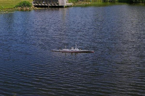

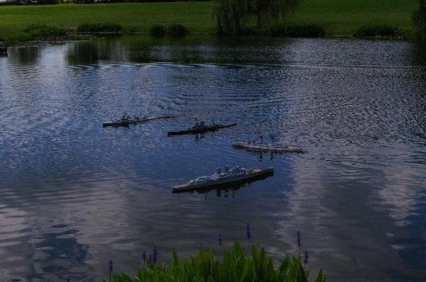

  14. froggyfrenchman
  15. froggyfrenchman
    Suffren, Courageous, Renown, and Markgraf.
    It appears that the photos were auto re-sized in my user folder, and the ones that I didn't try to post , when I loaded them into the folder are fine. The ones that I up-loaded into my folder, and then tried to re-size myself, are grainy.
    Looks like I can up-load photos into my user file, and then wait til after they are auto-re-sized, and they will load up fine in the forum. Way cool set-up.

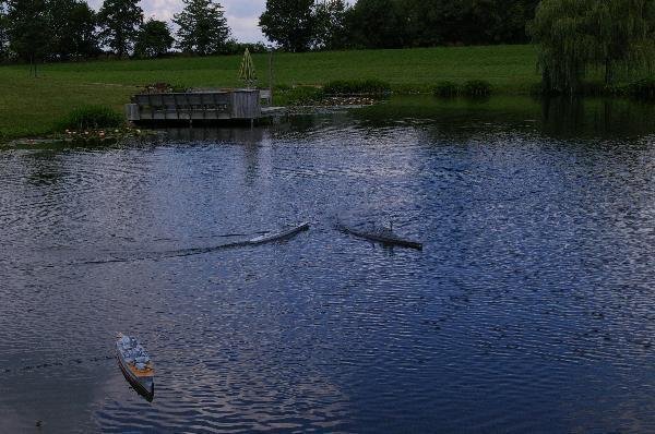

  16. froggyfrenchman
  17. froggyfrenchman
    Renown, Newport News, and Courageous.
  18. froggyfrenchman
  19. froggyfrenchman
    Mike D's Courageous.
    Our fastest capital-ship so far.
