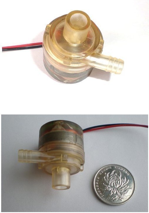

    Anybody ever fool around with one of these? The flow rate insn't all that but it's small, efficient, sealed, and cheap ($26). Thought it might be a viable option for class 1 boats.
    Steve Tyng
    Rated voltage: 12V DC
    Rated current: 0.34A
    Capacity: 1.5L/Min (24GPH)
    Pump head: 1.6M
    Noise: 10cm
    Working temperature: -40C ~ +100C
    Service life: 26000 hours up
    Motor: DC brushless motor
    Pump: Centrifugal pump
    Weight: 50g (1.8 oz)
    Inlet OD: 9mm (0.35 inch)
    Outlet OD: 7mm (0.28 inch)
    Dimensions: 32 x 26 x 36mm (1.3 x 1.0 x 1.4 inch)

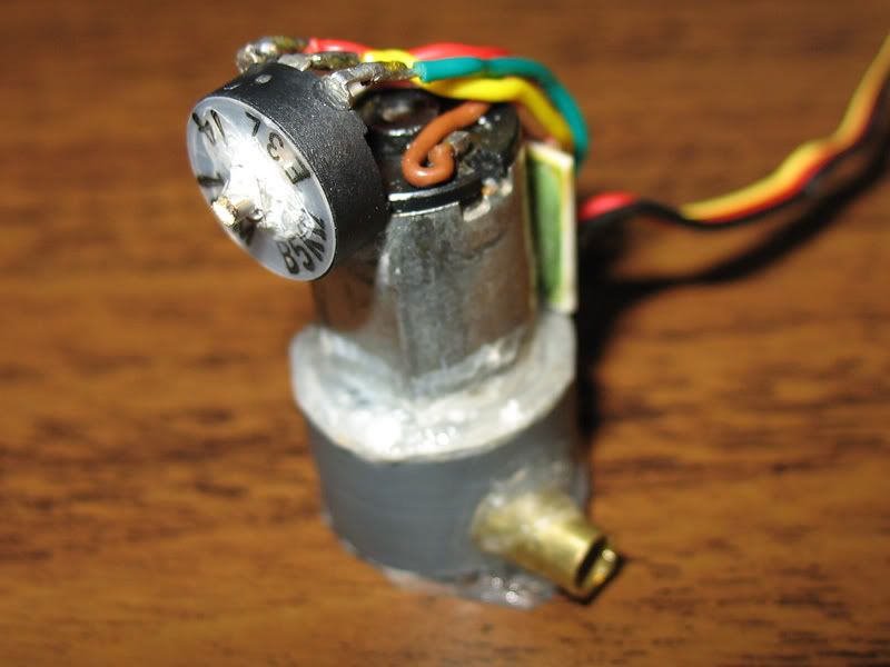

    That is basically the guts of an HS-81 micro servo on top of a very basic PVC housing and impeller. I used this to great success in the SS Willie Maykett, where it kept her afloat with two 1/4" holes in the red during one battle.

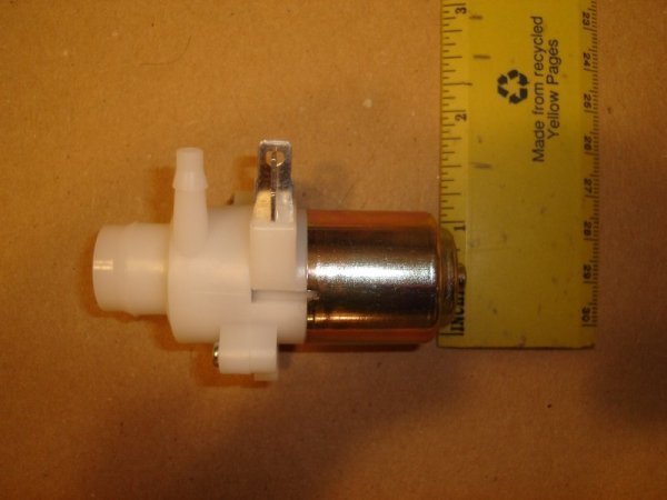

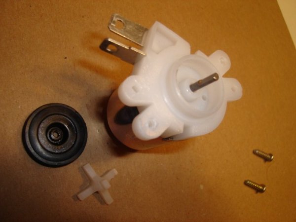

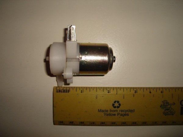

    Decided to take a look at what was available in a smaller windshield washer pump. This one for a Jeep Wrangler looked promising so I picked it up for $15. I'll be trimming it down to size and doing some flow testing this Friday.

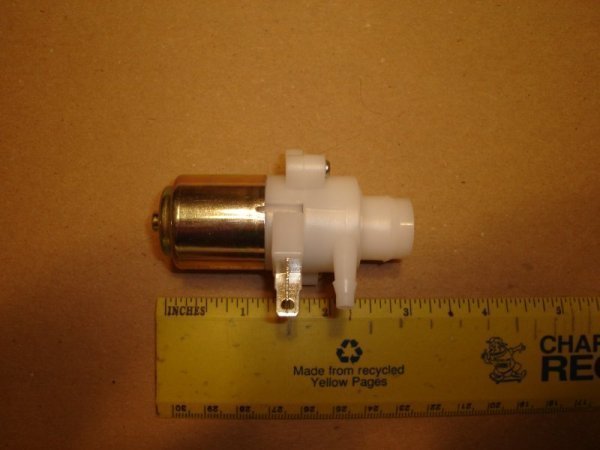

    Out of the box the pump is 3" long. Removing the suction tube will take that down to 2.25".
    The pic is a bit distorted, the motor can is a 1 1/16" in diameter,

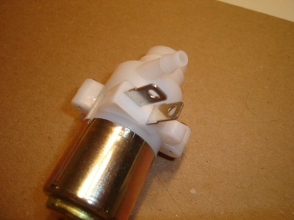

    What I liked about this pump is that the power tabs are on the side, reducing installation height.

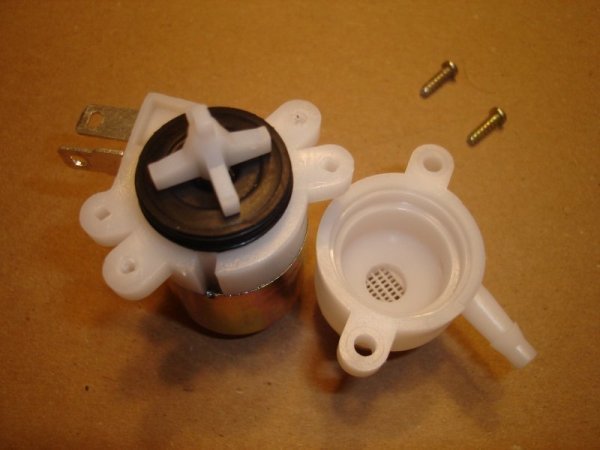

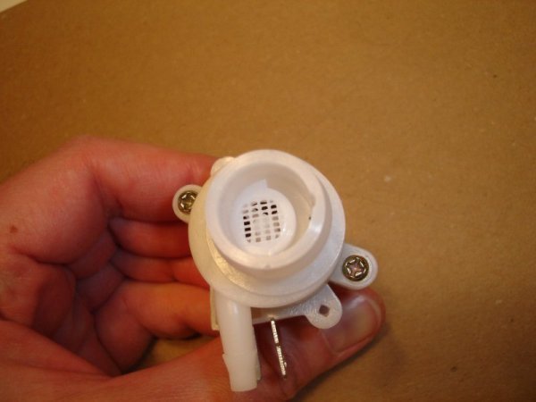

    A look into the suction shows a molded in debris screen. All this will be sawed off for testing.
    Unlike most windshield washer pumps this one can be disassembled. The impeller isn't exactly a high performance design.

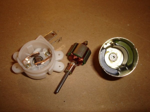

    The impeller is a slip fit onto a D shaft. The shaft seal along with some sealant around the motor can should make for a fairly waterproof device.
    Opened the motor can and was pleasantly surprised by these big beefy carbon brushes and substantial bushings.
