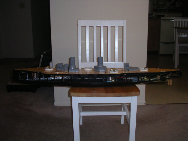

    I have an idea how do the cutouts and have read the rules and the BC directions included with the VDT kit but it would be great to get a look at how someone else has done the cutouts on a VDT.
    I missed an opportunity recently to see a battle that a VDT was to participate in. Hopefully there will be another chance in the near future but in the meantime.
    Would someone have picture of a "naked" VDT with its cutouts showing.

  5. SnipeHunter
    Thats my VDT at some points during construction, its been changed around but and the insides arent nearly as empty but it gives a decent view of the ribs. How you cut the casements is really the biggest issue you'll face, read the rules and try and follow them as best you can, there are lots of different interpretations and ways people deal with them. Ive had people tell me they should be done multiple different ways so im not sure what the best advice there is. Personally I have them cut out to be legal as I understand the rules so im not to concerned about them, but some people get uptight about it if you don't do it to their liking. Nothing to worry about just letting you know you might run into that.

    Snipe,
    The pic are excellent and just what I was looking for. Nice work. How was the Battle in Esopus? I really need to make the trip next time.
    Looks like your hull is painted black I was going to paint my VDT hull & superstructure black.

  8. SnipeHunter
    Glad to be of help.
    The battle was great. 4 allied boats against 2 axis boats with a rookie skipper on either side so there was plenty of action for a small battle. One of the allies sank with a pump failure/blockage and then I sank late in the second sortie with a cloged up pump screen. The lake was cleaner than in the spring but it still requires a beefy pump screen, I probably should have cleaned it between sorties, that probably would have prevented the sink but no worries they are designed to sink afterall and I was very pleased with my gun preformance.
    My boat has a standard grey and red paint job, the black is the unpainted fiberglass hull. I would imagine a black boat would be harder to find underwater and it would be harder to find the holes so you could patch them but other than that paint it however you want. In reality they should be really light grey almost a white but I dont like that how that looks so I went with something darker.
