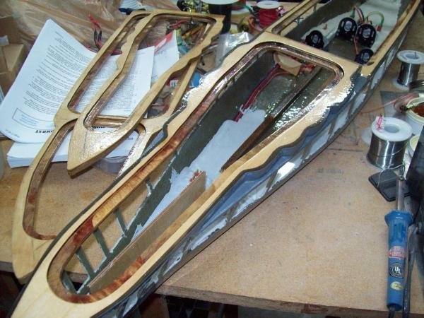

    Hmm, I just assumed the deck included with the BC kit was balsa but it may be ply. I'll check that out tomorrow. I know the sub-deck is ply, 1/4" if memory serves with a 1/8" deck (of some material).
    Mike, I assume by "scribe" the deck board you're referring to the technique djranier used on his and Don's Iron Dukes, right? Man, THAT impressed the hell out of me and I'd like to do the same thing on a future build, perhaps using ABS or Sintra instead of ply. I don't know if ABS is available in 3/8" or not but I think Sintra does come in that thickness.

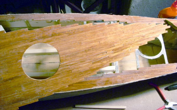

    You can always put teak on top of your deck...
    If you ask Greg, it was worth doing once... exactly once. I didn't find it as difficult (Admittedly I didn't do as much), I'll probably continue this if I become crazy enough to build another ship.

  9. GregMcFadden
    2,567
    If I were to do the teak thing again, I would do the following: Buy some 1/8" or 3/16" thick teak. Pay someone with a laser cutting table to cut me a deck out of it and scribe the lines. Teak is simply too difficult with the strong grain to get thin planks easily.
    Or, build the worlds smallest table saw out of a dremel and be very careful ripping the planks...

    I have never scribed a deck yet, I think he is talking about the 3/8 combined subdeck/deck, which I routered the inside edge, to form the lip to hold the deck on my Iron Duke build Mike.
  11. JustinScott
    JustinScott Well-Known Member
    2,258
    You don't need a dremel... Thin teak is easy to cut with scissors... If I did it again, I'd use a paper cutter with a width 'jig'.
    Then cut to length with scissors, tack in place with CA, and go over it again with clear resin.
