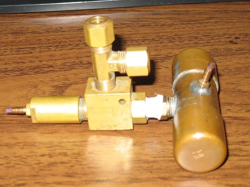

    The Arizona cannon (also called the MJV-2 cannon) is similar in basic operation to the Indiana cannon, but uses a clippard MJV-2 valve instead of a home-made valve. It can be open or closed breech. Only a single barrel can be fired from each valve, so multi-barrel turrets consist of several Arizona cannons chained together. These cannons do not rotate.

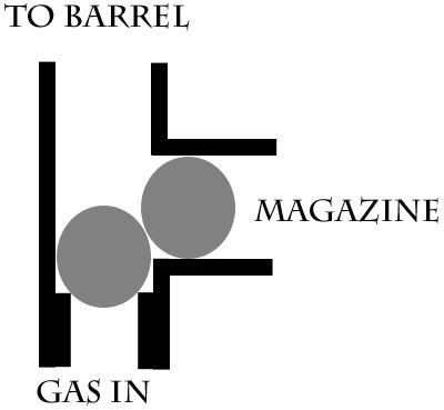

    The open breech used by most big gun cannons. The two balls overlap, so when one is fired out the barrel, it pushes the other ball back up the magazine, and prevents it from firing multiple balls per shot.

    A single Arizona cannon. You can see the accumulator, MJV-2 valve, MPA-3 actuator, and the breech.

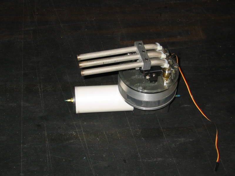

    A pair of fixed torpedo cannons. They are the same as Indiana cannons, but they don't have the separate rotating magazine.

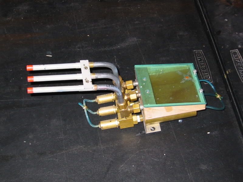

    A pair of unassembled fixed Indiana cannons. The valve, actuator, and accumulator assembly is exactly the same as a standard Indiana cannon, but the magazine lacks the rotation mechanism and has a square shape.
