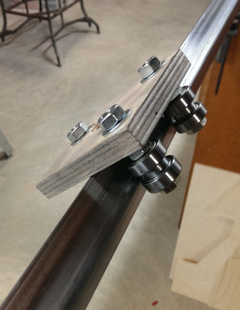

    Further adventures with linear slide ideas.
    Picked up some v-groove bearings. Much smoother and stiffer than the previous skate bearing setup. These bearings, a length of steel angle, and some plywood is almost as smooth and stiff as the industrial slides I used in a big CNC router I built several years ago.
    Testing a table edge mounting. Would have to fiddle with some angles to mount a gantry to this but no big deal.
