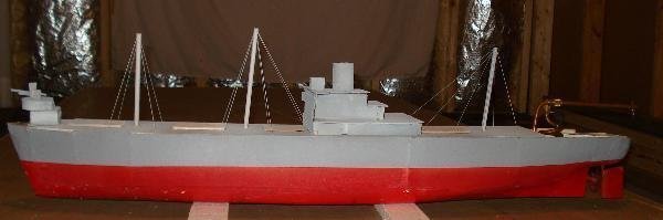

    Just look at the photos of Lumpy and you decided.[​IMG]

    I am assuming that you believe that the finished product would look like there was sand added to the paint.
    The texture would be very bumpy.
    The actual finish came out quite smooth!
    Not glossy smooth as it would need to be for an aircraft finish, but decent enought for a ship.

    From what I understand, most, if not all of the folks in my group use this method.
    I have not seen any cracking thus far. Only perfectly round holes.
    And I do believe that I have the photos to prove it.
