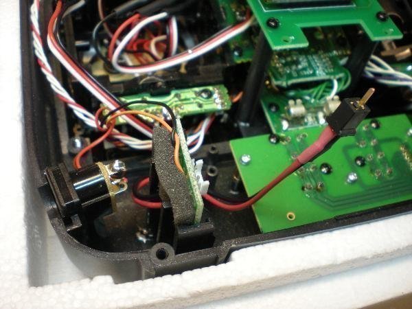

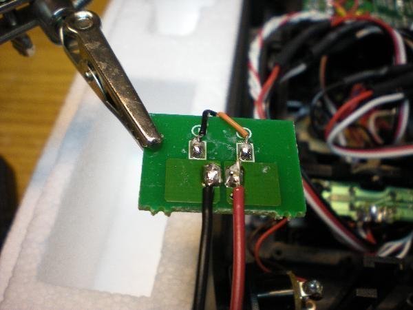

    ABOVE: I soldered the wires to the board that has the battery connector soldered to it. I added it on top of the soldered connectors so that it would still work with the original batteries if needed. I found that orienting the wires in a downward direction allows them to go under and around the plastic post and into the battery compartment.
    Above: You see the wires as they run downward and aroudn the plastic mounting and then up again. This will allow the connector to pass through the hole in the back cover into the battery compartment and also to allow the cover to close.

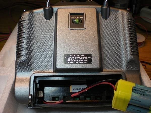

    Above: The cover is on and the battery is connected. It turned out quite nicely. I converted all of my batteries and will do the other radio soon.
