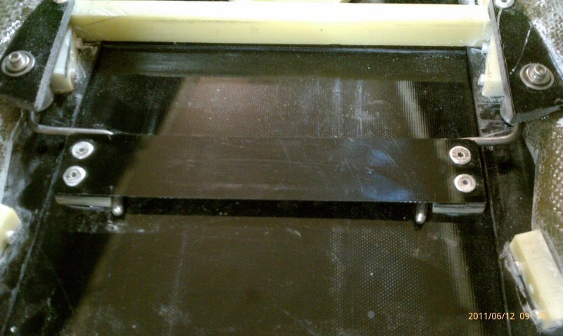

    Yes I use goop to hold in the subdeck Tugboat. And I get T-Boned by Yamatos and Bismarks regularly. But I also use 1/16 inch thick G10 for the subdeck and deck and rivet small blocks to the fiberglass hull to support it from underneath.
    This is a view of the underside of my main deck, a typical riveted block (yellow) supporting the subdeck (black) is in the bottom right of the photo. The subdeck is glued to the block with rubberized CA. After I cut the windows in the hull I went back and applied a fillet of GOOP around the edges. It has held up for 5 NATS and 2 regionals so far without separating.

    So you glue the blocks to the fiberglass hull, then drill them and pop-rivet them, and then glue the subdeck to the blocks, and Goop the gaps? Interesting. I'm using G10 board in SMS Gneisenau, I'll have to consider this.

    Yes that is exactly how I did it. Prior to Nagato I used a full thickness G10 subdeck in my Iboat (5/16 inch) and the weight was excessive (and Expensive). G10 is very heavy compared to plywood but a lot stronger, I don't see any need to go thicker than 1/16" for G10 decks and subdecks. If I was doing subdecks with wood again I think GOOP is still the way to go, especially if you can get a close fit between the wood and fiberglass hull, just be sure to waterproof the wood before installing the subdeck into the hull. Thin layers of GOOP are a very strong adhesive. I always had problems with wood subdecks breaking loose from the fiberglass hull when using regular CA or an epoxy to secure them.
