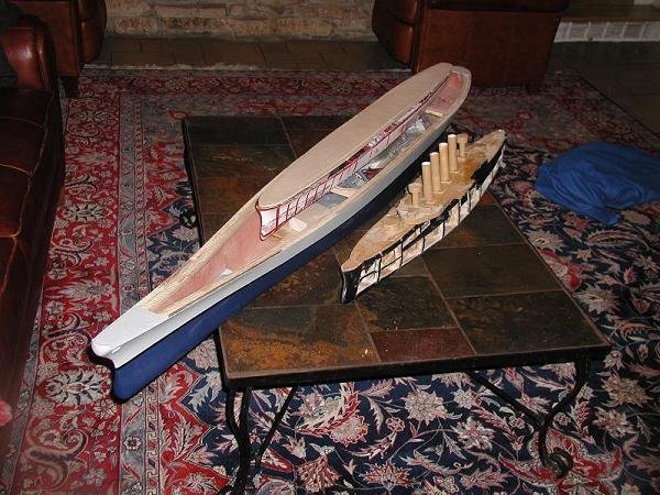

    My Yahagi sits atop Aaron's USS Iowa with Ethan's SMS Scharnhorst to the port side:

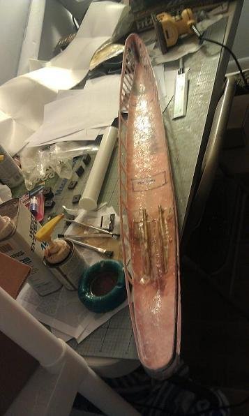

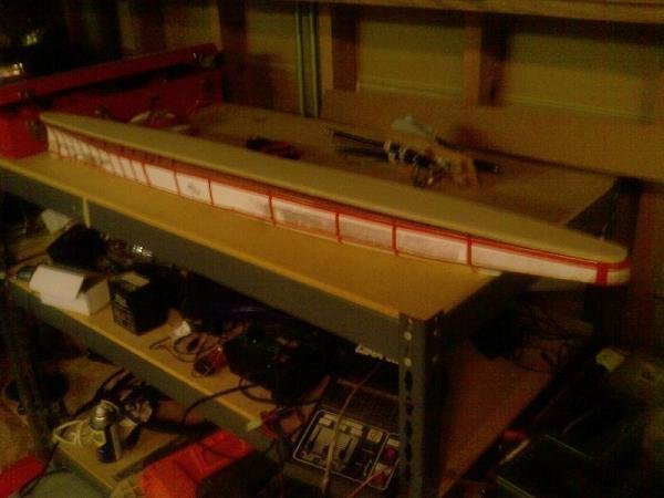

    In March, I converted an unused bedroom into a warship workshop. So far, it is working fairly well.

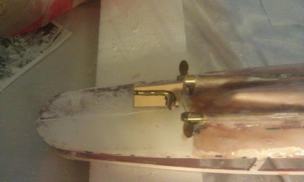

    The inner shafts after being fiberglassed into the hull:

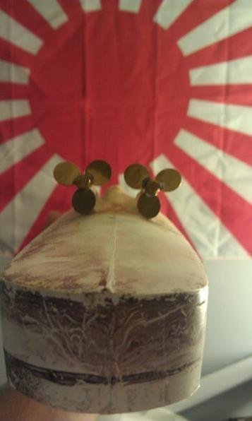

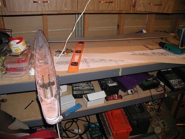

    The inner shafts/propellers from behind:

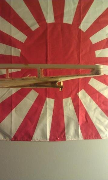

    ...and from the side:
    I'm currently beginning to design the rudder using the method Bob Hoernemann describes in his 'How to Build a Warship' video:

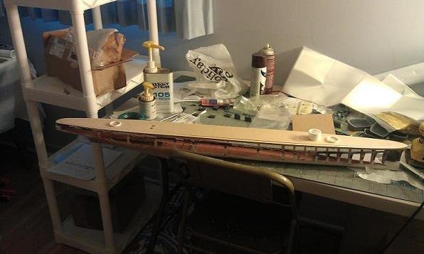

    I've also made some barbettes from 1.5" PVC:

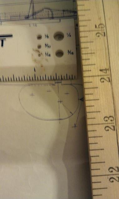

    Based upon a very quick analysis, it's close. Here is a quick picture:
    This is, of course, in 1/200 scale. So, I estimate the rudder is < 1 7/16" long and < 7/8" tall in 1/200, giving < 1.996528" long x < 1.215278" tall in 1/144. It isn't, however, square so we must subtract area. I assumed triangles in the upper-left, lower-left and lower right-hand corner, leaving the upper-right hand corner as a 'fudge factor', which were approximately:
    Upper-left: .260417" x .347222"
    Lower-left: .520833" x .694444"
    Lower-right: .260417" x .520833"
    in 1/144 scale.
    These triangles would subtract an area of 0.587746 sq in from the initial rectangle (2.426336 sq in), giving 1.83859 sq in.

    I measured the planset I have and it converts to 2.2008 square inches in 1/144. (Class 5 twin rudder area is 2.25 square inches per rudder) I did a slightly more accurate subtraction of the corner area, by measuring the radius of the curve, subtracting the size of a square and a circle using that diameter and dividing by 4 since there is only a quarter of a circleon each corner. I also used calipers to get a closer dimention estimate. Center of the bottom left circle from my planset would be about half an inch closer to the bottom left corner on yours.
