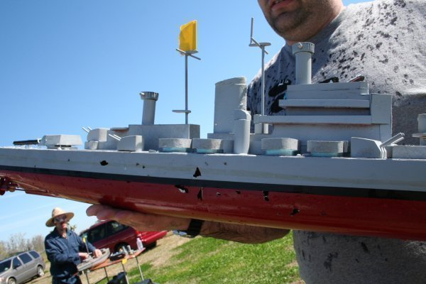

    HMMM They want to put holes in me...I don't want to have holes in me...I think I'll just stay over here and shoot a them...
    Putting holes in the bill board
    So...Um...always remember to make sure your transmitter batteries at up to snuff....otherwise sinkage might just saddle up next to you and occure...quickly!

    Man you got some holes. Hopefully the water was somewhat warm.
    Wow that is a lot of major holes. What kind of battery issues were you having? Receiver, Tx , or Drive battery issues?

    Two things:
    First off, what a great battle site! Where is it?
    Second: looks like your balsa treatment needs some work. Looks like midwestern balsa which is hard and splits easily (order soft balsa from Balsa USA or Battlers Connection). Also I can't tell if you used tissue on both sides of the balsa but that helps splitting too. We (the IRC) use contact cement to glue the tissue to the balsa (spray), then a coat of dope (laquer) and contact cement (gell) for attaching to the hull.

    For the second, as that was the first time I had ever skinned a boat having only ever read how to do it before, I wouldn't be surprised if my treatment needs work. The balsa was from BC and it does have a layer of silk span on both sides applied with nitrate dope. Attached to the hull via weldwood contact cement. Though, neither to dope or the contact cement was cut with MEK as I couldn't find any at Lowes at the time. I now have a can which should at the very least help prolong the usage of both the dope and the contact cement.
    It was suggested at the battle that it might have been the paint that caused the balsa to be brittle or the fact that as of the aforementioned sinkage that was only the second time that hull had actually been in the water. Whatever the cause, I plan on trying a slightly different process the next time I sheet.

    Johhny did not do all that damage. As you can see in the one picture my Iron Duke is backing up to him, and I fired my sterns at him a few times, he wanted me to to see what kind of damage he took, and it did indeed blow some nice large holes in him. The next time out Johnny added all the belows, and some of the aboves.

    I saw some of the same balsa splittling, and cracking the first day, Sunday it had about stopped.
