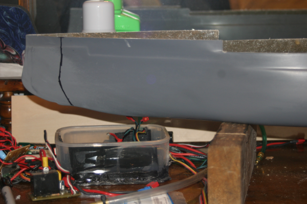

    And now for two pictures of the Kron Prinz
  3. Bob
    In the bow before the step down it looks like you get the 1/8" stringer right where the little bump is.
    After the step it looks like there is another bump for more 1/8" stringer. It looks like that runs from the step in the hull to the stern.
    Put the 1/8" on the lower part of the bump.
    I don't think the bump is big enough, it's barely a wrinkle in the hull. I love my stringers, but that's a stretch :)

    I want to keep the detail of the bump in the hull. In pictures I have seen of 1/350 scale models it is still a bump,but defiantly looks like it was placed there on purpose. My thought is that it is the top of the armor belt to the ships hull. I did not think it was stringer worthy, but want to find a way to keep the detail and stay legal.

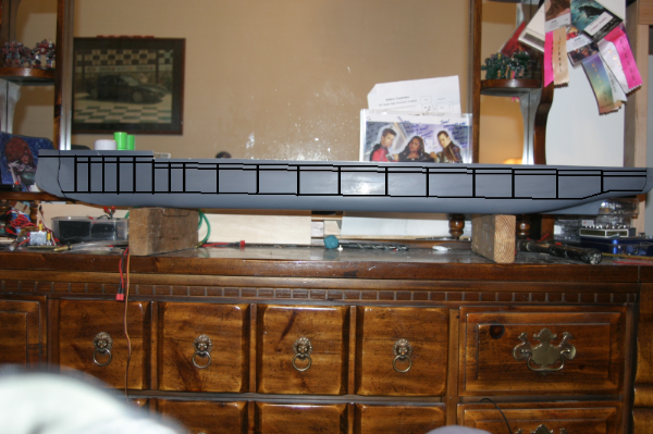

    This is how I cut the windows on mine John, about all I have done so far.
    The top edge is of course the 3/8 inch deck and subdeck. Only in the first forward window is there no armour belt, the rest of the ship lenght has one. I think in my drawing I added one extra rib. I have 6 ribs in the forward section, till the first step down, then 2 closer together, and the last 9 are evenly spaced out towards the stern. About every 3 1/2 inches or so. Mine will look just like Evil Jokers when finished.

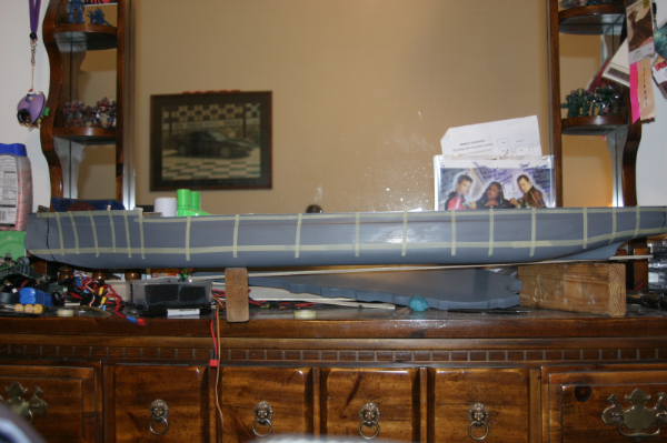

    Port side taped up so far. Gotta get some 1/8" tape to mark the armor belt still.

    YES THAT IS IT djranier YOU SKIN DOWN 2 BELT THEN UP.YES one rib needs to go
