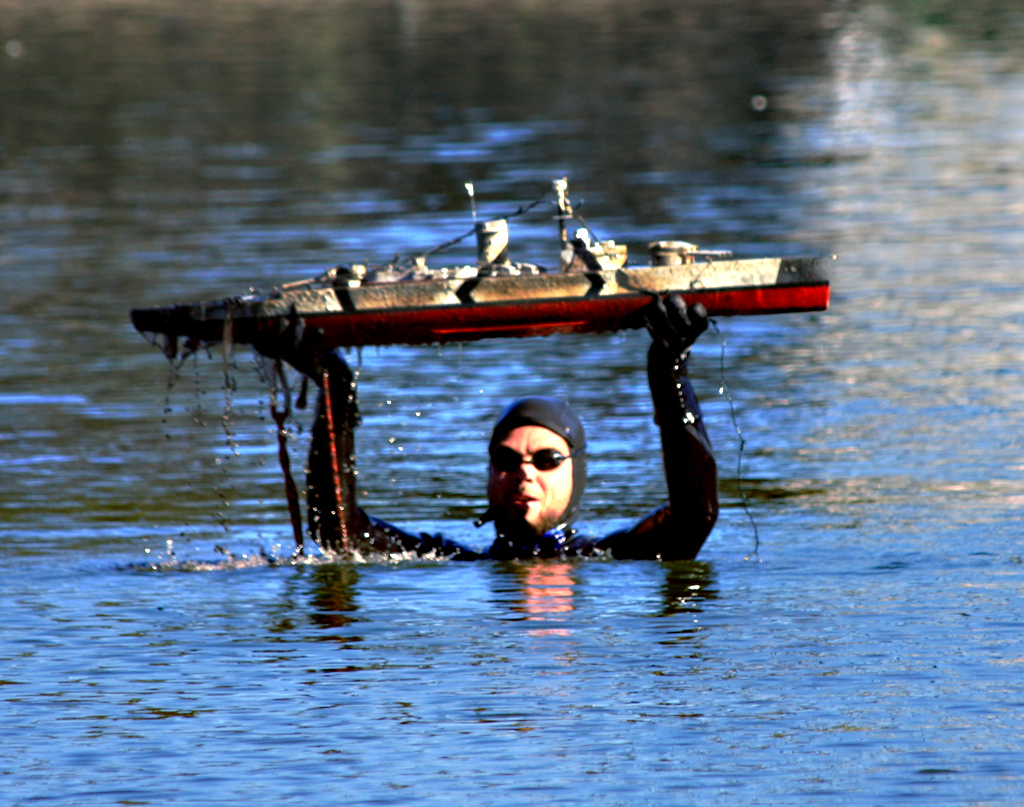

    I use a few brands of acrylics for camouflage, simply because they're brushable, clean up with water, and have no fumes. I have recently discovered that, as long as you let the paint thoroughly dry, they're fully waterproof.
    Check out this photo. It's my Lützow after spending 31 days on the bottom of a lake. The paint is still intact, although the grays are discolored from algae having grown on them:
    The art supply store brands, such as Grumbacher and Liquitex (there are literally dozens out there, by the way), are expensive, but highly concentrated. Often a single coat is all that's needed, making them convenient for doing repairs. For sheer volume at a low price, though, Behr Premium Plus, sold at Home Depot, is hard to beat. The wonderful thing about them is that you can buy them for a couple of dollars in what they call Sample sizes (7.25 fl. oz. in a plastic jar with screw-top lid). What's even better is that they will mix these sample jars to match any color sample you give them. The red on the hull above is Kriegsmarine hull red. The light superstructure is Baltic Hellgrau, and so on.
    The black stripes are Grumbacher Mars Gray, because I happened to have some, while the white stripes are Liquitex Titanium White, for the same reason. All three brands held up well, except that the Behr Premium Plus red on the hull developed "pimples" of lake water that I had to pop, then iron back down. The Behr grays I repainted, while the black and white stripes showed no damage from 31 days of immersion - I'm guessing because I painted them on without thining them.

    I will be going to Lowe's this weekend with color samples! The Profile Morskie color plates of Roma have color panels to use. Excellent post and the pic is truly inspiring. After 31 days, she rises from the briny deep!
