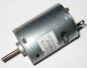

    Look at the RS380PH series for a smaller lower rpm option
    Mabuchi RS 380 Motor 12V Great for R C Applications | eBay
    Mabuchi RS 380PH Hobby Motor 7 2V DC 2000 RPM Great for R C Boat Apps | eBay
    I used RS520 series pancake motors in my Mogador and their low rpm torquey little bastards but they have leaf brushes which tended to burn out. I'm still looking for a variant with carbon brushes.

    I've just bought 10 Mabuchi RS360 RH motors (6V, 12,000 rpm) from ebay. Those are what I've used in all my Class 2 and 3 models - it took quite a while to find some for sale. I've used high rpm RS380 SH or Graupner 400 motors for bilge pumps.
    Looks like the RS 380 PH might be better for small drive motors that the RS360 RH if the rpm is only 2000 at 7.2V. All my models run on 6V. I run small drive motors on direct drive, having tried some gear reduction systems in the past but not finding them significantly better or worth the expense and added complexity and length of the drive train.
