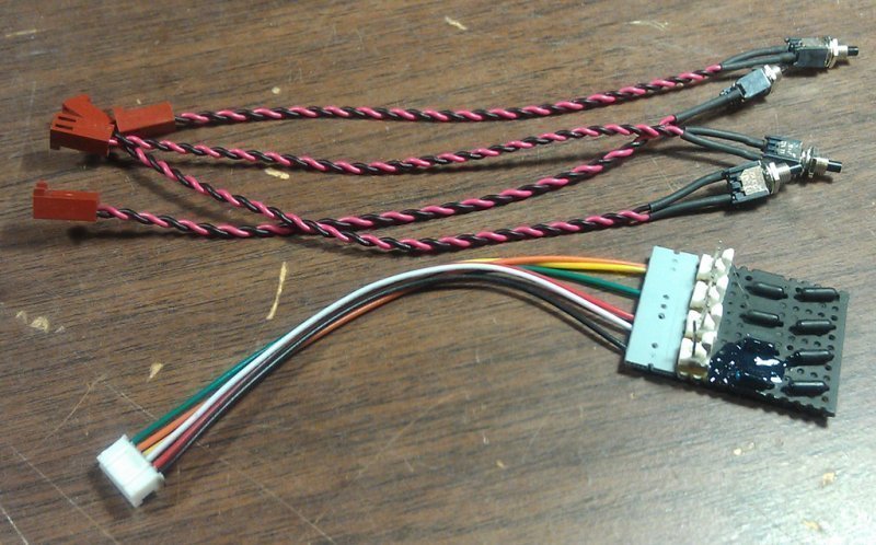

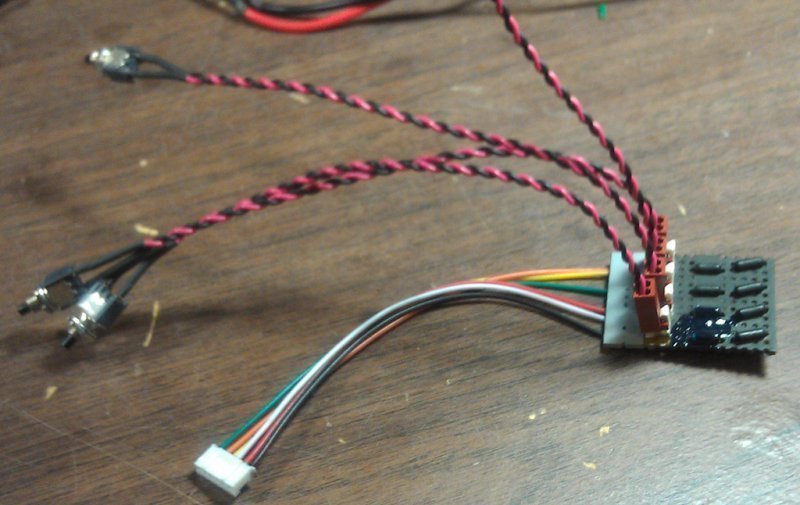

I have been working on this for a while and found the right radio to do it with. I created a button conversion kit for the Spektrum DX6i that allows for a fast 'bolt-on' solution without permanently damaging or altering the radio. I wanted to be able to return my radio to 'factory condition' and with the DX6 I wasnt able to do that. Certainly I could have just unsoldered the wires from the potentiometers and put them back later but the work would be obvious and there is a risk of damaging the potentiometer in the process. I found a way to leave the potentiometer intact and usable in the future. To install the kit all you need to do is open the radio, take out the 4 gimbal screws from the front, unplug the gimbal from the main board and set it aside, make and screw in a switch mounting plate, plug in the board, plug the switches into the board, close up the radio. Its super easy and the buttons I found are very fast action, very light touch and allow you to go almost as fast as you want. Any buttons can be used when they are soldered with the right connector. I plan to offer this as a 'Battle Rabbit' product in the future. Thanks, Johnny

Send me a picture of the internals, specifically where the wires for the potentiometer wires attach to the circuit board of the radio itself and we will find out. I suspect that many of the newer DSMX radios have the same setup - DX5e DX6i DX7s DX8. I hope to take a look at a DX5 this summer at Nats and maybe a 7S / 8 as well. If you have time snap a picture and send it over to me by PM
I would really like to do this to my radio. Are you selling them? Or do you have a parts list that I could use to make it myself?
UPDATE - I did get access to a DX5E and found that it will work with this module as well. Its more work to get to the connector but it will work. J
