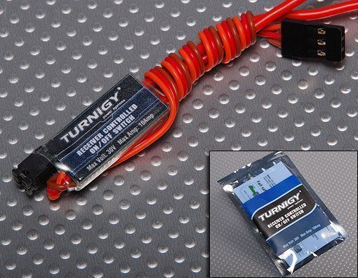

    Item: Turnigy Receiver Controlled Switch
    Mfr: Turnigy
    Price: $6.63 each
    Available from: Hobby King Online
    Stock Photo from www.hobbyking.com
    It is no secret that I use Hobby King for ordering lots of neat items such as brushless motors, ESCs, LiPO batteries, etc. So when this little gem popped up during a random search, it immediately caught my attention! It is the Turnigy Receiver Controlled Switch, touted as a electronic switching circuit for turning lights and accessories on and off in RC cars and planes.
    Two things made me buy a few for testing. First, it is a Turnigy product. Although a Chinese company, Turnigy has a rapidly growing reputation in the USA for quality products. All the Turnigy products I have bought over the past couple years has worked well enough to risk the investment for testing the switches.
    The second thing was the price. At $6.63 each, the cost is a fraction of other switches on the market. If the Turnigy switch doesn't work out for model warship combat use, then I didn't lose too much trying it out.
    Two weeks later, they finally arrived. The first thing I noticed was it's small size ... about 30% smaller than a Delta switch and a whopping 60% smaller than a RAM switch. The servo lead to the receiver was pre-soldered on. Another noticeable item is the rather thick wiring on the switched side of the card to handle up to a 10 amp load at 30 volts. Rather robust looking!
    It also has two pairs of pins on one end with a jumper block on each pair. That was unusual, so I consulted the well written, small, single page manual that comes with the switch to see what they were for. As it turns out, the pins are used to set the switch on or of during a fail safe mode. That means if the radio signal is lost, then the switch will default to either on or off until the radio signal is restored. That could be handy in keeping a pump turned on in case of radio failure!
    Since the HMS Erin was under a partial refit at the time, three of the switches were installed to operate cannon solenoids. Another switch was potted in resin and wired into the FN Verite's pump switching system. The small manual included color wiring diagrams to make sure the switch is wired correctly. Like the Delta switches, the Turnigy is wired in series between the positive battery terminal and the load (solenoid, relay, etc). The instructions did not call for a diode, so none were installed. The Erin's switches were set to off when in fail safe. The Verite's switch on the pump was set to on during fail safe mode. Setting the fail safe is as easy as consulting the manual and removing one of the two jumpers from the side pins.
    Now I have to admit, the first test under power was not promising. The Turnigy switch turns on and off when the radio signal PASSES 50%. At neutral, the switch remains on it's last setting until the transmitter stick or button is pressed to change it. Basically, when I pushed a cannon button, the switch stayed on and sent power to the solenoid AFTER the button was released. To turn off the solenoid, I had to press the opposite button.
    Not good at all for operating cannon solenoids ... works great for pumps though. Heh.
    Realizing the switch needed an opposite radio signal to turn off, I moved the trim levers towards the off side of the channel. That worked! Now the switches turned off when the button was released. Later, I took advantage of the computerized radio's sub-trim function to electronically set the trim to the off position. Subsequent button mashing gave a consistent on-off action like the Delta and RAM switches did.
    The Turnigy switches were tested during intense battling over the Memorial Day weekend. They worked flawlessly the both ships all weekend, unlike the brushless ESCs and pumps that plagued the ships every sortie. Heh.
    So, to sum up ...
    Good:
    - 10 amp load capacity and thick wire can handle multiple solenoids with one switch
    - Switching speed is fast enough for the fastest button masher
    - On/Off settable fail safe feature
    - The $6.63 price is 1/3rd the cost of the next switch on the market
    - Turnigy is a reputable company
    Bad:
    - The 50% radio signal requirement forces transmitter trim adjustments to use the switches for cannon solenoids.
    - Turnigy is a Chinese company, so do not expect much from their customer service department
    Overall, I would recommend the Turnigy Receiver Controlled Switch for use in model warships. It has some nice features, clearly understandable instructions, handles a 10 amp load, and low cost. The transmitter trim adjustment may be tricky for older radios, but not insurmountable.
