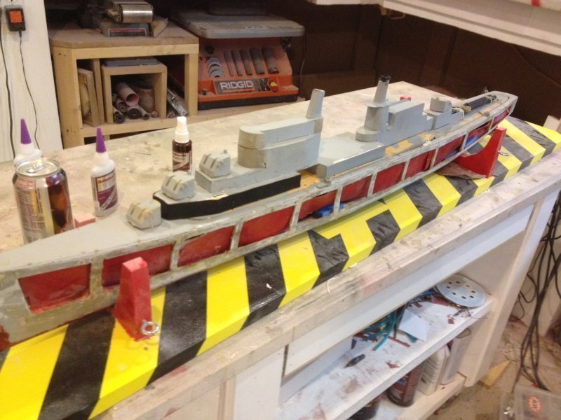

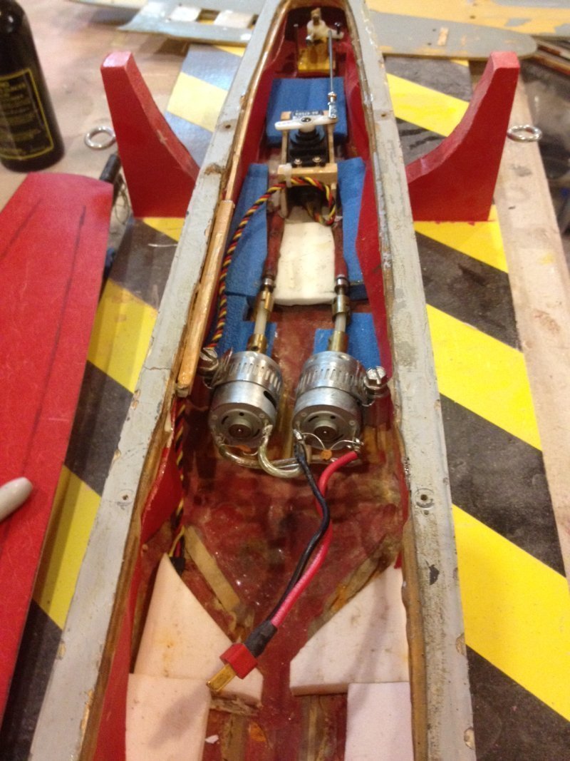

    Here is the original boat, the super is 1/16th ABS and not fitted to the decks. The decks are attached with servo arms, I will be changing everything but the hull on this rebuild.
    Bow shot, was originally setup to use a cut down Williams regulator. Foam is to create a water channel. The holes in the deck are where I have already removed the servo arms.

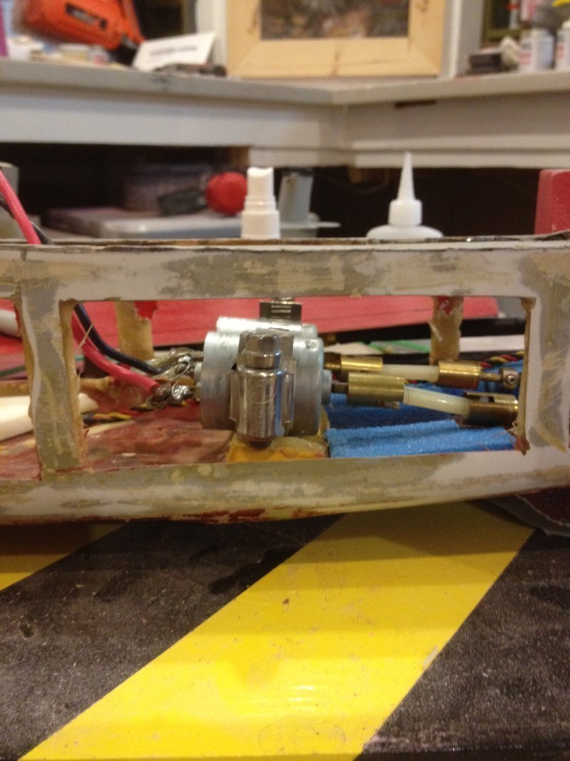

    Direct drive small motors (they are seized up), O-clamps to hold them in the boat. I will be replacing these with my own 380 geared motor mounts.
    Angle of the drive motors, they sit too high in the hull.

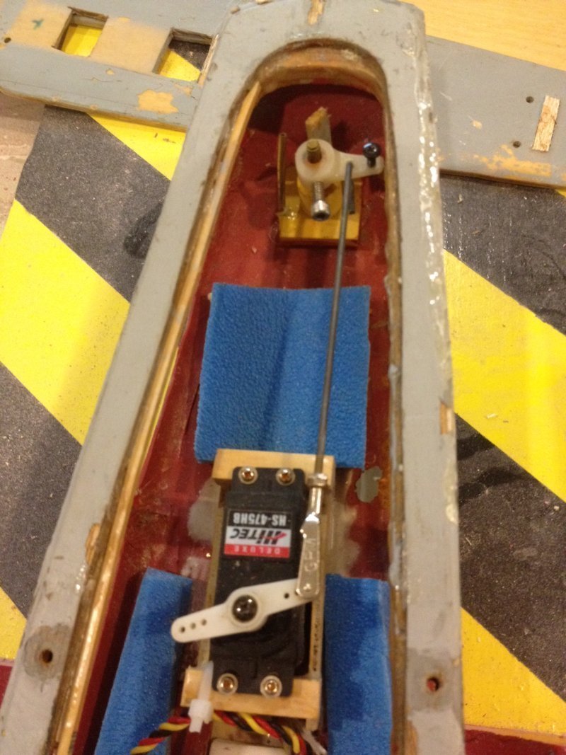

    Rudder servo was effective, but I am not a fan of a single arm attachment. I will be replacing this with either a geared mount or double arms, depends on how much room I have to work with in the stern.

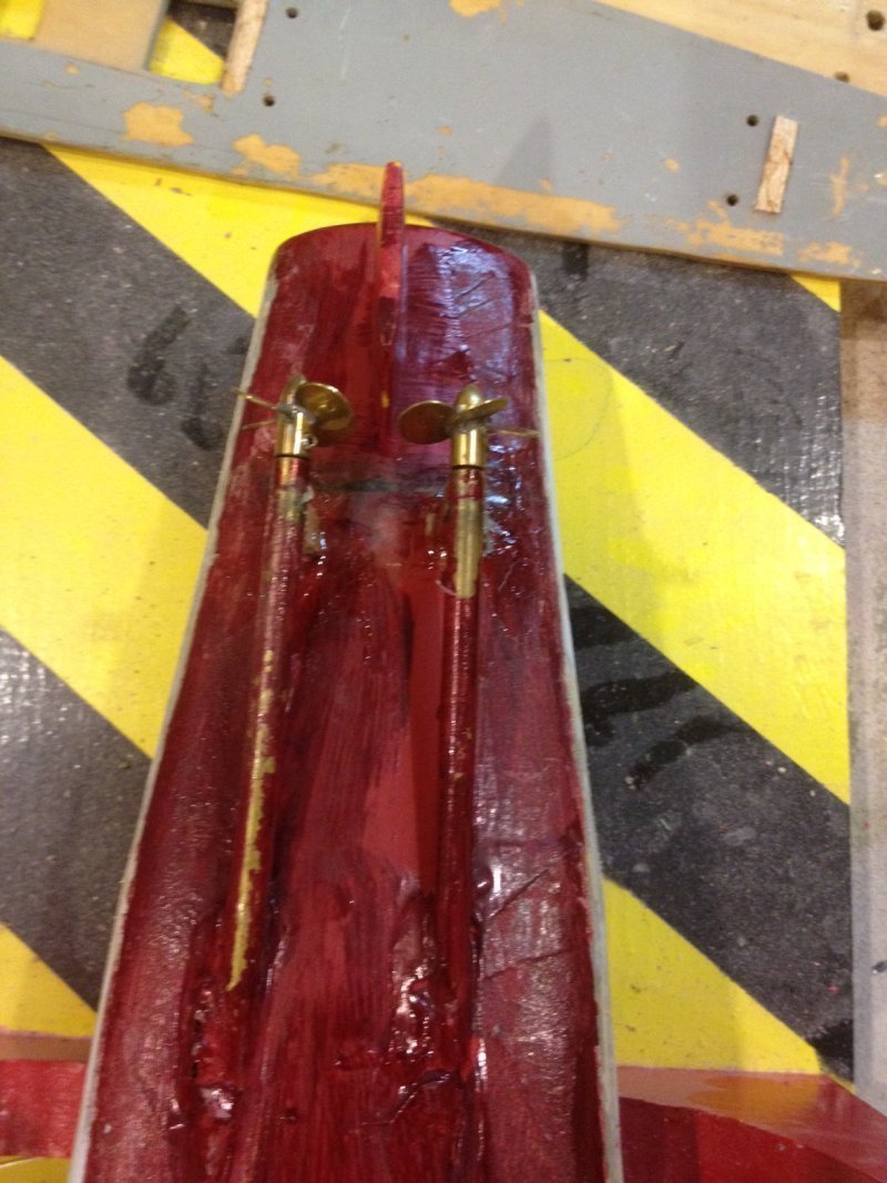

    Prop shafts are not centered, I will tear these out and make a jig to center them.
    Props should sit closer to the hull. In the current state, the thrust is going down instead of parallel to the keel. Speed is very important to this little ship, so this will be corrected as well by installing new shafts.

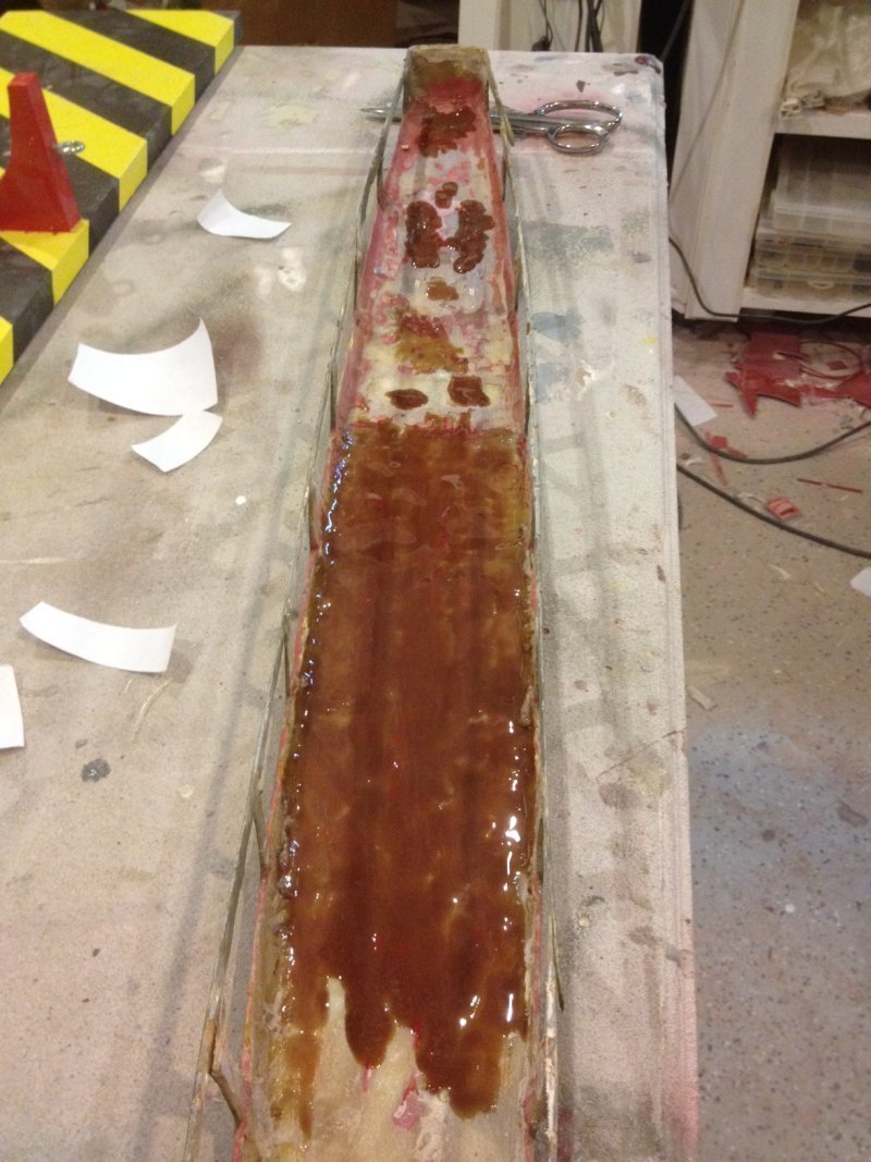

    The hull has been stripped of the subdeck and deck, motors removed and all foam removed. The motor mounts were secured through the hull with nuts superglued, this left two big holes to be filled. The sander went through the hull in a couple of places as well while removing old resin/superglue. Prop shafts have been removed as well.
    The shot below is the hull after rough sanding and being spayed with primer, still lots to do but this will get us started.
    Using a mix of micro balloons and west system epoxy, I placed tape on the outside of the hull over all the penetrations and spread the mixture inside the hull. We are now back to a hull that has had the sides cut out, everything else is ready for building.

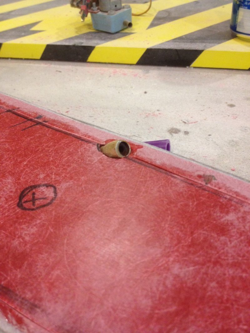

    The Deck on this boat will actually be comprised of three decks, but the weight is not excessive for a well sealed hull. If you look closely at the deck, you will see the preliminary bump out for the pump outlet holder.

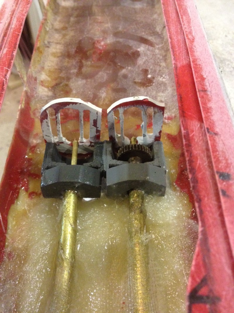

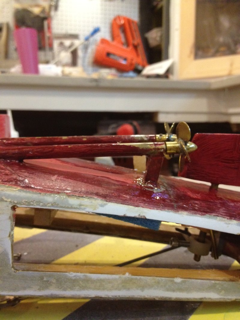

    Cut out the bottom of the boat so I could install the gear boxes and shafts. Everything was done with West System Epoxy and fiberglass cloth. In this view you can see the three deck design, all three are made of 1/32 board.
    The shafts are almost parallel to the keel, this is as good as it gets.
    Reusing some gearboxes, I cast them myself for 380 motors.
    Pump outlet is installed through the deck.

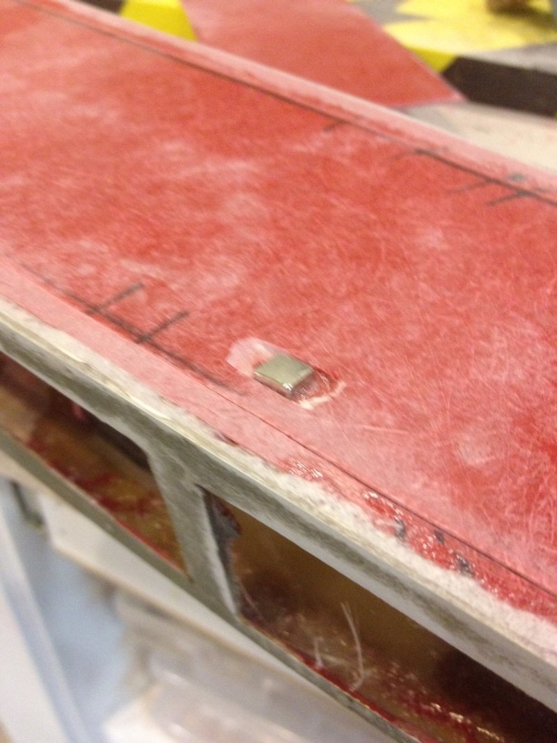

    For holding down the deck I am working with rare earth magnets.
    As one side of the deck slips into place, the other side needs something to hold it down. So the bump outs I put in the sub deck are utilized for holding the magnets in place. On the deck, I carefully grind out some of the material and place the magnet in the groove. I will use epoxy and fiberglass to make these permanent.
