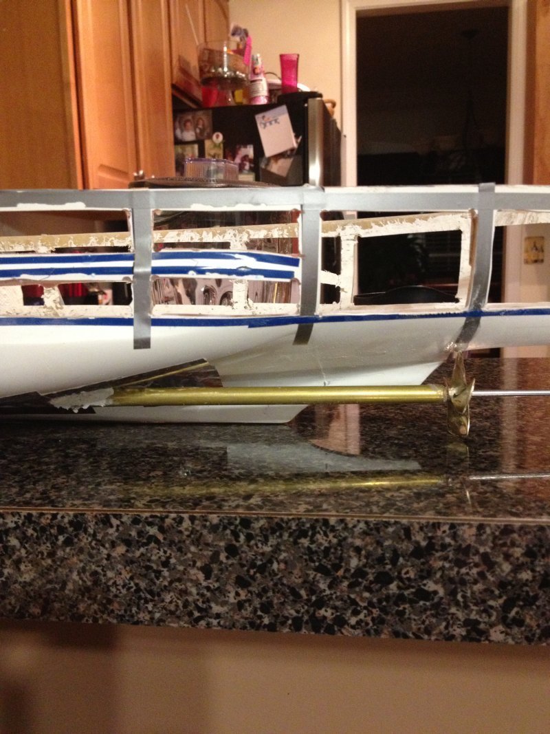

    Get them angled out, will help with turning. Also, get the shafts a level with the bottom of the boat as possible. If you have too much down angle, you will lose the thrust over the rudders.
  4. Lou
    Here's what I am talking about (from my QE build)
  5. Lou

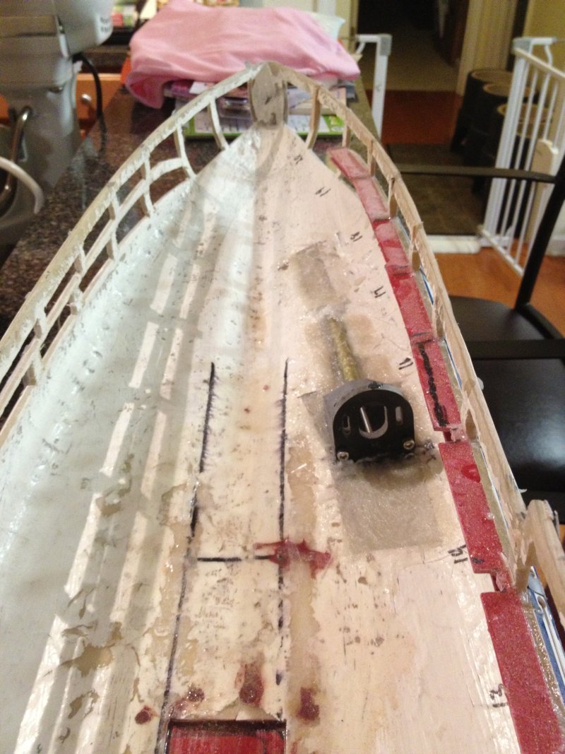

    Angle the shafts. Dont be afraid to sand off the bottom of the gearbox, or better yet cut out the hull and drop it in and then sand. I can help you use that West Epoxy.
  6. Lou
    Gearbox cut through the hull. Use putty around all the pieces, then sand.
  7. Lou
    Sand the boxes down until you are almost all the way through to the gears. Then use some fiberglass cloth and epoxy and smooth it all out. Now you have big sexy bottom (of boat). Nothing stopping the water and just small bumps where no one can see them.
