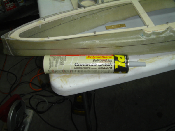

    Hey guys,
    I am looking for help with a product that some are using to build water channel. It is some sort of rubberized self leveling agent that is poured in to the hull. Sections can then be cut out with a knife making a water channel. Anyone of hear of such a thing?

  4. djranier
    10 oz tube of selfleveling polyurathane concrete patching material. What I used in my PE, and Mikey D uses. Works great, just used it in my Mogami also.
    Purchased it at Home Depot. Just make sure it says selfleveling on it, the non-selfleveling comes in the same type of tube.

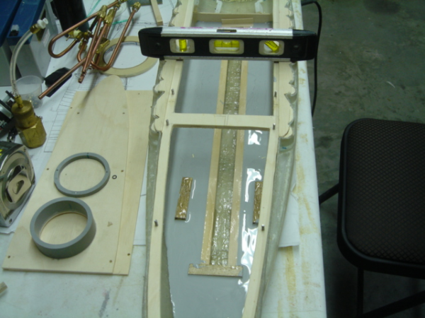

  7. djranier
    One tube is 10 oz. My PE took right at 18 oz, and my Kumano took 12 oz. But due to its long lenght, it is only 1/2 as thick of course. But it really helps with the turning, having the weight down low. After about 2 days you can start working on the boat again, but it takes about a full week to fully cure, before you can start cutting on it. and then its just like rubber.
    Brought to you by Mikey D, and his gang. Thanks Mike, I just love the stuff.
    You can just pour it in, and then cut out the water channel, or build a frame, and fill in behind as I did on the PE.
