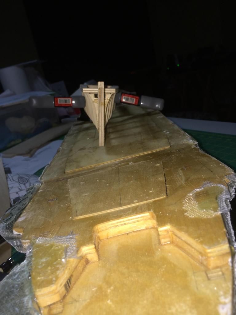

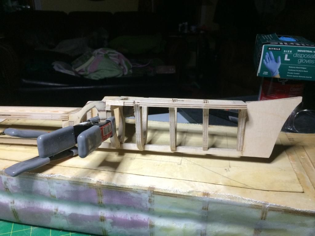

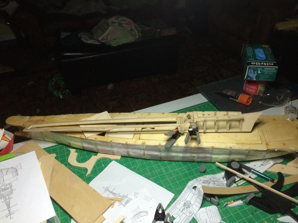

    either allergic to epoxy now or got a fiberglass fragment in a nerve cluster. After trimming the hull i can't feel the left side of my face under my eye very well following where my mask sits.. kinda feels like Novocain is wearing off in that area. but has been going on for 3 days.. so i can't wear my resp till i figure out exactly what the issue is. at least it is getting better now.
    working on cursing my shimakaze now, almost got the front re-redone...again. After the glue sets on the repairs i had to make i'm going to set the first 6 ribs and work on finishing the rest. insofar the jig i made for dealing with the slope seems to be working and i need to look at the rules again to see just how large the impenetrable area in the bow can be.
    Edit added pictures of the 1/144 Shimakaze sitting on the 1/200 Yamato hull
    and yes that Yamato hull is still very rough. see previous paragraph as why.
