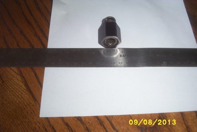

    Question for Tug:
    Do you know what size capsule this adapter takes? It has a 1/2" opening. see picture.
    Thanks, Ship Crazy[​IMG]

    It looks like the adapter used for an 88 gram disposable CO2 cartridge. The threads on the cartridge are 5/8" which gives an internal diameter of just over 1/2".

    There are 1/2" x 20tpi (maybe 24tpi) threaded cartridges as well. I believe they are more often used in industrial type applications.

    thanks guys! I'll check around for capsules?

    The 88 gram cartridges are available at walmart at two for $12. That might save you shipping costs and if you don't puncture the seal, you should be able to return them if they are the wrong size.
