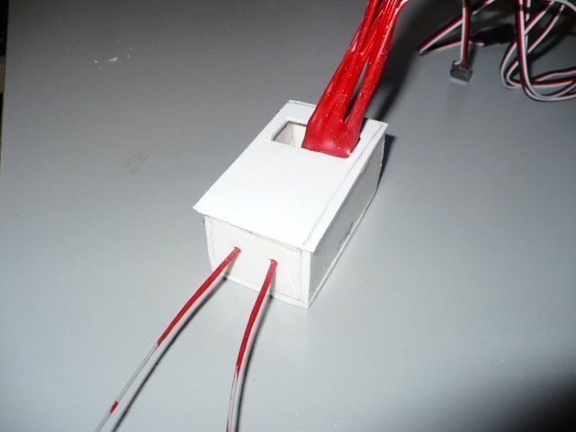

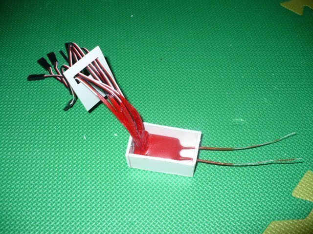

    Ther receivor is waterproofed and so far its working fine. Just some minor adjustments to placement. It looks like a cockroach instead of a receivor. I'll post pics to show you what I mean in a few days.
