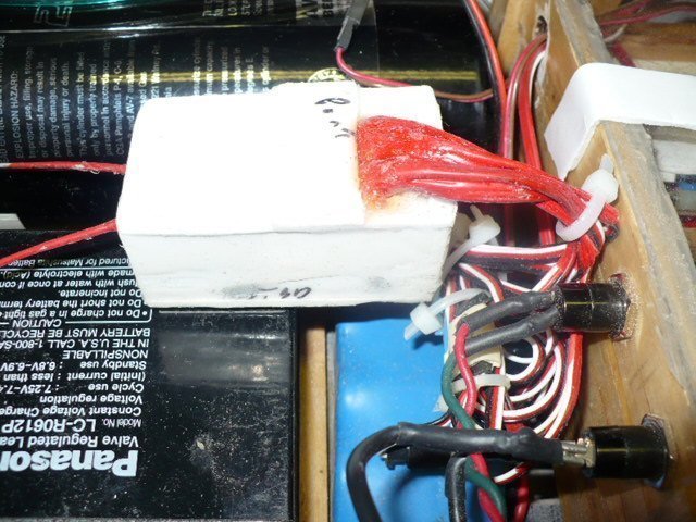

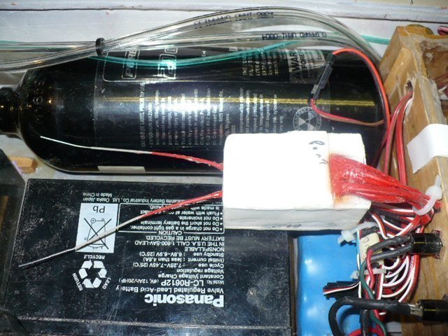

    So far it's working well.
  4. wrenow
    wrenow RIP
    Jul 30, 2007
    439
    Hmm. Tooldip. It will work just fine until it delaminates over time, at which point, corrosion will set in, of course. I would scotchkote those antenna ends, at least.... Otherwise thwater will wick in and rot the antennas.
    Cheers,
    The receivor should be just fine as the box is sealed tight and the recievor has 3 coats over it. Should be a long time before that delaminates. Even if it does the box outside seams are sealed with Marine Goop. The Antenneas are sealed at the entrance points with Marine Goop however I will scotchcoat the Antennae leads. Thanks.
