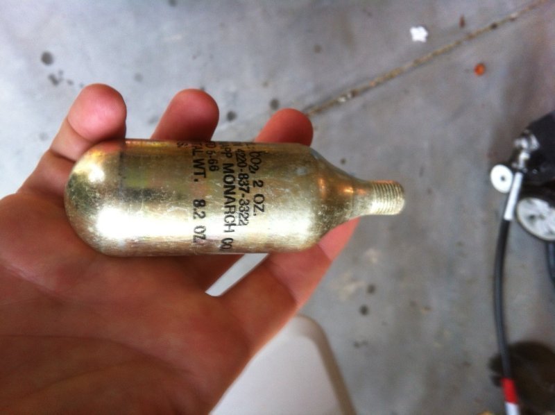

    Here is the story. I was putzing around looking at various co2 cartridges when I stumbled across these cartridges on ebay. 2oz of co2 in a cartridge that weighs 8.2oz (I double checked that weight). They are old (1960's-70's). Cost after shipping... approx. $1 each. I have 72 of them now:whistling: If all other accounts are correct 16grams of co2 can fire 50 rounds with a smidge of pressure left over. This cartridge is approx. 56.7g. Which means they should be good for tweak session and 175 shots from a standard cannon. With the high flow Stalnaker Mangus (SM) cannons I fear my number of shots might drop. However we will see.

    I just noticed it looks like I have stubby little cabbage hands.......lol!!! They are somewhat thick... but not quite sausagesque;-)
    Lol almost looks like Toe-fingers...

    The cartridge is 1.5" wide and 4.5" long. Threads are .5" by 20. Found a manufacture date on a box... June 1966!

    Those cartridges are almost as old as I am!
    They're very probably obsolete, but hey, if they work, you'll get your money's worth out of them.

    I doubt they are obsolete... otherwise I wouldn't have spent the money:) I used the internet to it's fullest to research them beforehand. The threads are a common type and easily adapted to all regulators commonly used in this hobby. Co2 tanks (and cartridges I assume) under 2" in diameter never require a "hydro" by the consumer. If it still weighs 8.2oz then no liquid co2 has been lost.
    A physical failure upon utilization is the only thing I can think of as an issue. However, the boxes these came in (original manufacturer's packaging) are of a very thin cardboard that is very suseptible to high humidity and temperature fluxuations. That packaging is in pristine condition and that indicates storage in a temperature/ humidity controlled environment. I think they will work like a charm. I found some old powerlets (cartridges) for a bb gun once and they worked like new. Granted they were *only* 25 years old.
