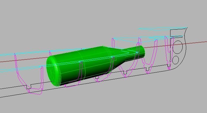

    Very interesting. That size bottle could handle a 3 unit cruiser and it would fit really nice below the deck on the Henri IV. And since the Henri IV is 3.5 units in Treaty, I really need something between a 12 gram adapter and a 3.5 oz bottle - which does not fit below the deck. Do you happen to know if there is a burst disk on the end with the plastic cap? If there is no burst disk, or other pressure release, we really can't use it.

    All of those alternate refillable cylinders are cool but don't seem to offer any real weight savings. The disposable cartridges with an adapter seem like the lightest option. I would say that the lightest feasible option is an aluminum 3.5oz with an aluminum or lightweight on/off valve. It still weighs less than a pound when full.
    On the Henri IV I was planning on affixing the bottom layer of superstructure to the deck and sealing it. Then I was going to rework the underside of the cross bracing at rib three to allow the bottles regulator to stick up under the focsle. Then the bottle itself will be poke up under the superstructure. I really think it'll work.

    Mike - I think you have the right idea on placing a 3.5 oz bottle in the Henri. It will fit, but it would be nicer to have a smaller bottle to work with. The 2.5 oz bottle doesn't really save weight, but I'm more looking for smaller size than saving weight. Unfortunately, that 2.5 oz bottle is very long and will have its own installation problems. That 35 gram bottle looks really attractive based on size, and I would expect some weight savings as a bonus. Steve - is there any chance that the adapter on the 35 gram bottle has standard CO2 bottle threads so that you could replace the plain adapter with a valve and burst disk like this one? http://www.rap4.com/store/paintball...-off-valve Right now the twin 12 gram adapter looks like the best bet for what I need, but since I'll have 2 x 75 round guns, gas will be a little too tight for my comfort. By the way, where can you get 24 gram cartridges and are they threaded or plain?
