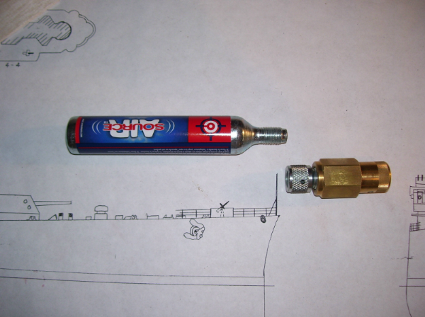

    Well I went and purchased some today to try out. Crappy Tire sells a two pack for 22.99 and the adapter for 6.99 plus tax. I bought mine at Walmart, 16.96 for a two pack and 5.98 for the adapter plus tax.
    First picture is as bought and the second is with the adapter screwed into the BC standard regulator.

    Just a note, while hooking up Little Rock's cannon system tonight, the 88g adapter will not work with the standard regulators. It lacks the protrusion on the inside that keeps the piercing pin rigid when the adapter is screwed in. However it works fine with my Palmer regulator, which has the little knob on the inside which pushes out the piercing pin and allows it to puncture the capsule.

    The main issue was that the penetrator moved about 3/16" up and down in the adapter.So when screwed into the standard regulator,when you screwed the capsule in it just pushed the pin away. My Palmer regulator has a little knob that keeps the pin from moving away.
