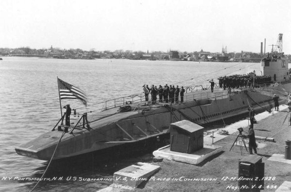

    V-4 would make an excellent submarine to model; simple shape and big (for a non-I400 sub!). That said, it's not nearly as big as I400 (nor is Surcouf). I rate V-4 higher than the surcouf for a dynamic diver because the superstructure on V-4 is MUCH less of an obstacle to diving. The big gun turret on Surcouf would, submerged, act as a large control surface pulling the sub UP.

    I-400 is the biggest submarine out there. Only problem is there's not much room for accessing steering gear, etc. It gets VERY tight in the stern. Surcouf is pretty good, too. I believe it is more roomy in the stern, but it's been a while since I saw the Surcouf in my club. It was an old wooden hull :0 There was one American sub that was also really big, and had a wide, flat stern. That one was particularly interesting because of how easy it would be to fit in sturdy, standard steering gear. I don't remember which one it was, though.
  9. rcengr
    It's the V-4 (AKA Argonaut, AKA SS-166) with the wide stern. At 381' x 34' she's the biggest American sub I've been able to find.[​IMG]

  11. Anachronus
    The V-4 is bigger than a flush deck destroyer!
