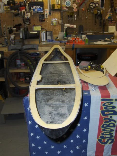

  6. rarena
    My deck on mine is all settled in, sides are stripped and armor belt cut for penetration. Primer coat is on and will begin re attaching details soon.
  7. Powder Monkey
    waiting on build session with captain Don, teach me he will yes. Don't want to mess it up i know there is a lot of controversy over that cut
  8. rarena
    I ended up putting a 1/8th drill bit through and running it the length of the rib. I have my pictures on my computer so I'll take a couple of minutes and upload them.

  10. rarena
    water channel is blue foam down sides of boat with channel in middle. I epoxied two wood strips in on bottom, covered all with fiberglass resin. I'm not sure how I would do it if I had to again but the cement looks promising. Here is the picts of the armor belt.
    this is the before, here comes the after...
  11. Powder Monkey
    is that cut in the center of the grove or on the slant part going to center cant tell

  13. rarena
    the cut is right above the 1/8th stringer. There is 3/8ths from the top, 1/8th cut, 1/8th stringer which sticks out even with the ribs kinda like this
    [__ deck top
    [______ armor inset
    _________ 1/8th cut
    [ 1/8th stringer
    [ ribs
