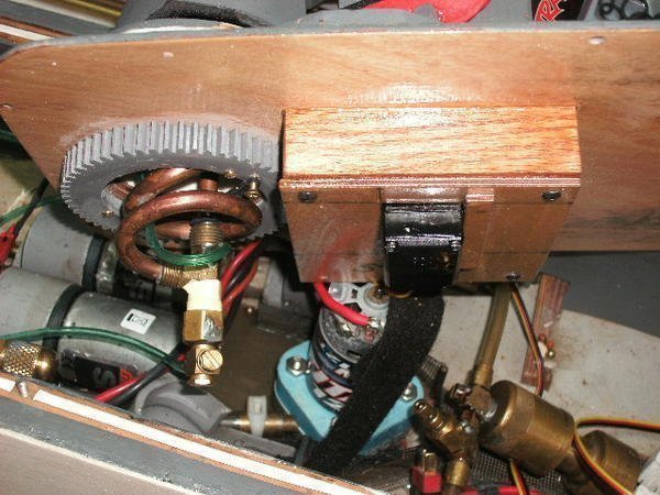

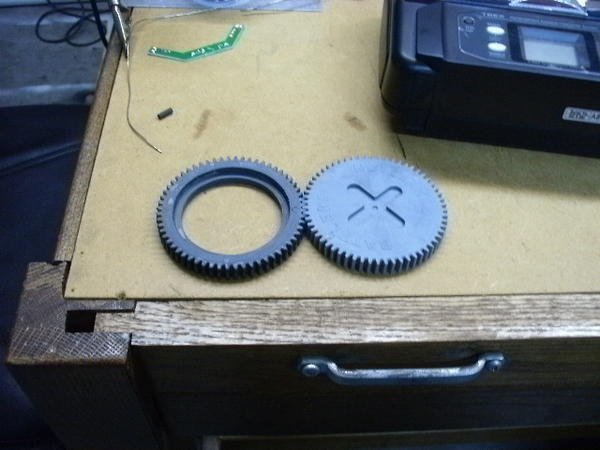

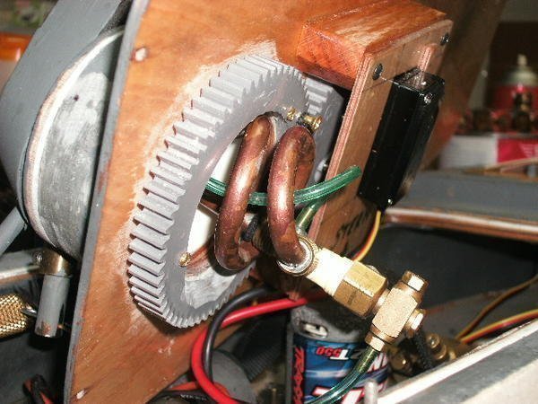

  10. djranier
    Here are 3 pic's I took.
    Actual gears I'm using. These were made by Charlie at BC, he sold off the moulds, the fellow that had them decided that I could buy them from him, since I was pestering him to make me some more. He's getting old, and said he was afraid that his wife would just throw them away anyways when he passed.
    Side shot, since the gear are a 1 to 1 ratio, I did cut the inside of the wood away so that the gear fit between the wood sides of the servo mount. I found that the wood was the perfect height for the servo with the gear mounted on it. The servo is not screwed down, just floating in the hole.
    I was going for the simplest, and easest to maintain mount possible. You can see I had cut away a bit of the one gear trying to make it lift over the stern turret, to keep the barrel longer, but as Rick said, your only shooting a foot, cut the barrel off. He was right, keep it simple.
    I used the grey pvp pipe as the outer barbett, with the white as the inside, added a layer of teflon tape to the outside of the white pvp, and she turns very nice, plus it filled the slight gap between the inner and outer barbetts. If you look real close you can see the little black hair band I took from my daughter to act as a tensioner to hold the gun down at 20 deg.
