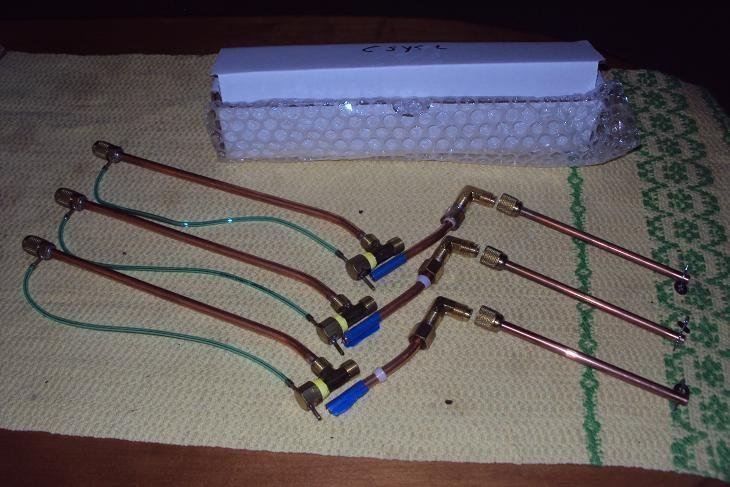

    With out a doubt a beautiful site! Unfortunately the shipping and duty added 50% to the price of the gun kits, but, if you can find a couple of captains willing to go in on it together, it's 66% better! This treasure box arrived yesterday from Battler's Connection. I wonder what could be inside?????

    Here we are. That's more like it. A trio of Cruisers will soon be hunting the fine waters of New Brunswick with these bad bouys!
    Lee has opted to run a single cannon for now and will upgrade to a two gun system once he gets the feel for firing (plus it was cost effective for him). Will has his dual stern cannons, and the french fleet will have a new addition soon! The Spee... hehe will soon have some teeth!

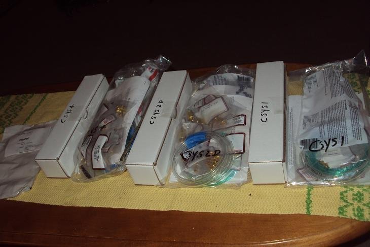

    Lee's kit for his english cruiser. He is still unsure if he wants to go bow or stern for the cannon? Any thoughts here? He wants to start with whichever is easiest for him.
  17. Craig
    Craig Active Member
    Dec 30, 2006
    1,537

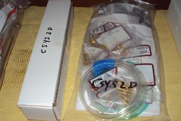

    Will's crusier looks great on the outside, the rest of the internals are ready to install, now that this is here, it will be a snap to get the ship ready for combat... I just hope whatever side he is fighting against is ready for him!

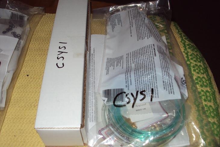

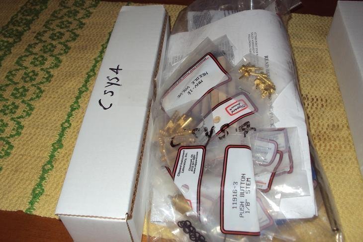

    Captain Jack's Kit. Should be good. Should be very good. I have never had an issue with the kits I have boughten before from BC. So this should literally piece itself together. The kits come with instructions which are most appreciated and so are any spare parts (especially the o-rings, can't have enough of those). I had forgotten that a speed loader and safety goggles were included. SWEET!

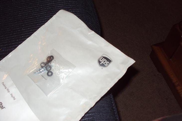

    And Pins. Cannot have enough extra pins. Safety first! I think in all it took five business days to get to here from Florida, so that's pretty good.

    Sigh. Just could not wait to see the goodies. Looked over the cannons, they all look to be top notch. Excellent craftsmanship. Thanks BC. Mine enemies shall taste cold BB's!
