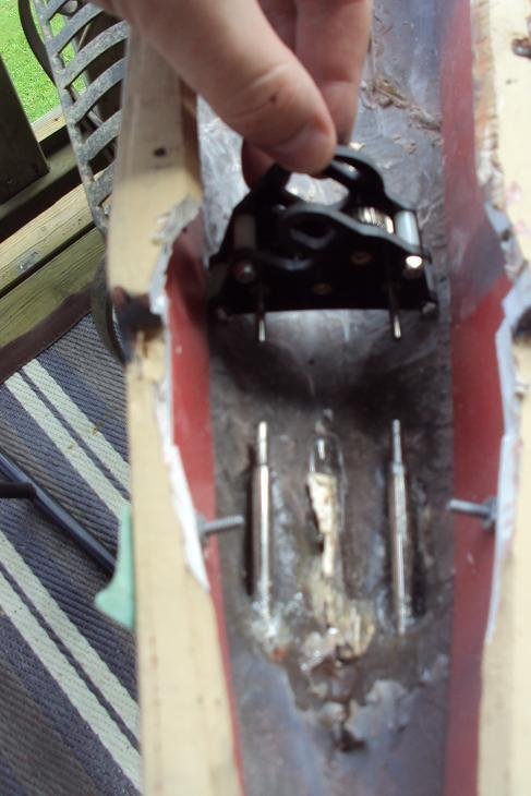

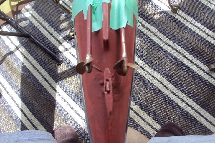

    Setting one shaft in place and holding it there with some painter's tape I was able to see what relationship it would have with the drive mount and it seemed to lining up very nicely. Superman agrees! Coffee for an early Sunday morning. Who's kidding, this is boat building right? It is a prerequisite! I like the new location of the shaft and I was making all attempts to ensure both were coming into the hull at the same angle...

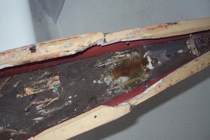

    This "looks" good. Again not having worked on a cruisers from the groundwork up, Just going based on what looks/feels right and what I remember from Battleships. Pretty sure everything is relative. Except of course the water line at the stern.... must have been rum involved there.... wow.....o_O

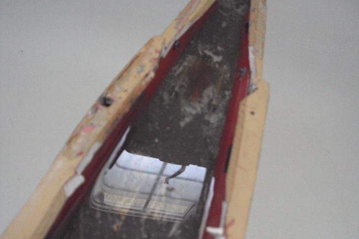

    I think that looks pretty good.... although I miss my old camera, took way better pics. Anyways back to work!

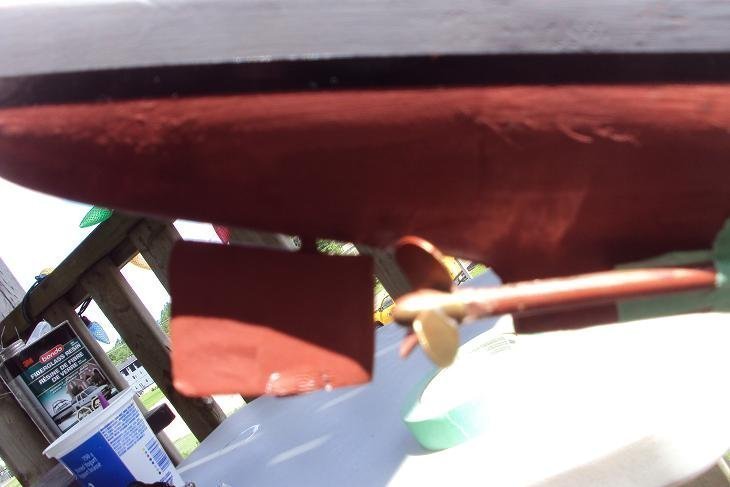

  4. Craig
    Craig Active Member
    Dec 30, 2006
    1,537

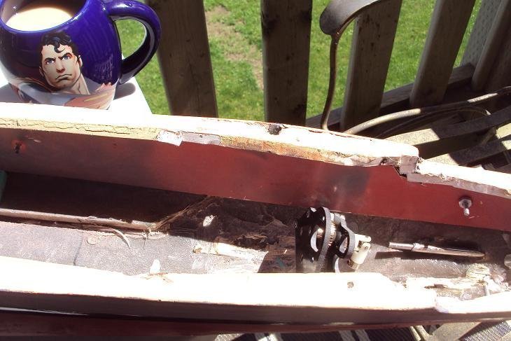

    I think he's got it! I think he's got it! :D Very pleased with how this is coming out. Tacked them in with CA and kept the tape on so they don't move so much. You can see the bottom of the rudder there as well.... looks like it can just come lose at anytime. Will try a repair on it, if not will have to try and make a new one.

    Damn I miss the old camera.... the shafts look the part. I will have to drop the mount in and get a idea of how close this coming. The Shafts at this point are still in with just a little CA. The port Shaft had to be redrilled out as it was at an angle that was too extreme and I wanted both to match as much as possible.

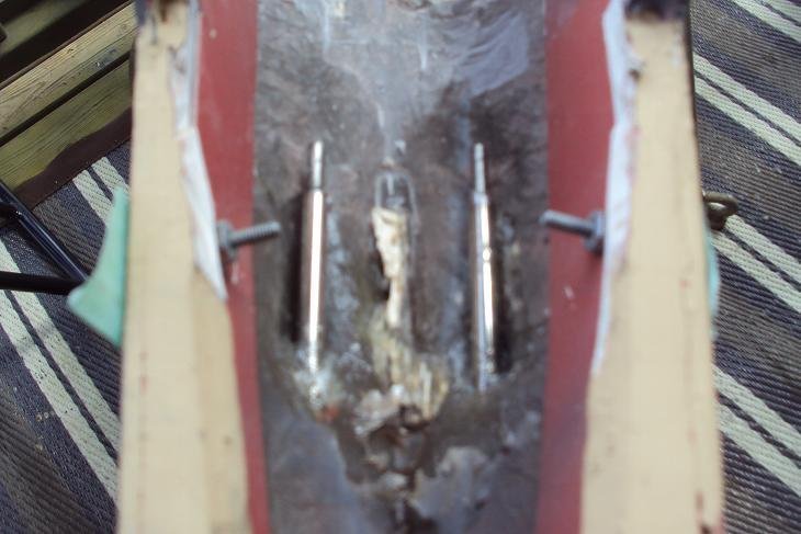

    With a little adjusting this will even out quite nicely. The shafts appear to be the same width as the mounts, so this looks extremely promising and I now move to the next step. Glassing in the shafts.

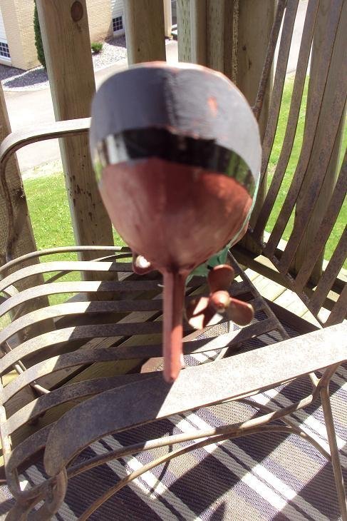

    Sorry for the unrelated photo.... Hal Jordan has been witness to the entire process, and at one point wanted to get into the Graf Spee. So since he was at my feet, I thought I would snap a quick pic off. He is the mascot for the fleet after all and will probably be around for the whole thing.

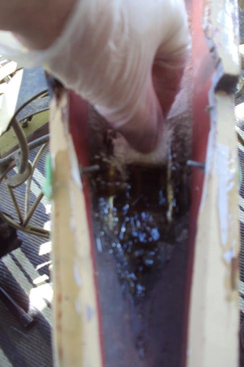

    I used part of a sheet rolled up to stop the flow of resin (although I must admit In the nice weather here, this will not take long to dry. I used parts as well around the shafts and in between. Trying to get it flattened out a bit to see if that will be a good spot for the rudder servo. (those with a sharp eye will see Hal's head resting on his paws... he fell asleep.... jez it's hard to find good help)
  9. Craig
    Craig Active Member
    Dec 30, 2006
    1,537
    :cool:Sweet. Already hardening up. It will be nice nice and solid and cut down on vibrations... Also hit the deck (or what remains of it) from top and bottom.... I may just get rid of the deck completely... start fresh. hmmmmmmmm I'll give this the night to cure and then get rid of the excess fiber and resin. Took the tape off hte bottom and the holes sealed nicely for the shafts. looks great! :cool:

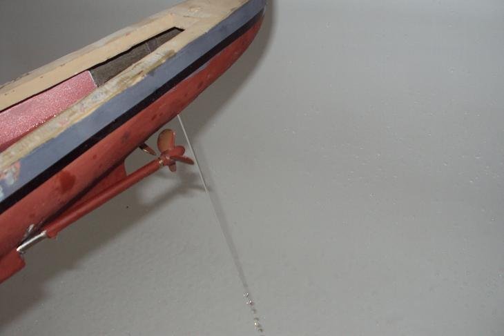

    Dec 30, 2006
    1,537
    Found a spot! :laugh: Actually it's ok. That's from where the rudder post should be.... I did see a couple of spots, so I will go over the hull again and when I paint around the shafts it will more than likely (forgive the expression) Seal the Deal! :woot::woot:

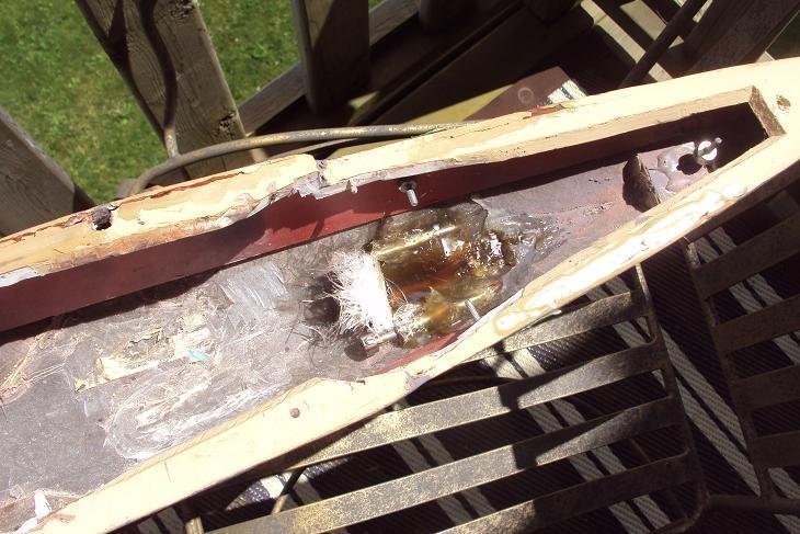

    Dec 30, 2006
    1,537
    Here's the product of my labor to this point. I am pleased with the outcome for sure. It is a solid seal and only a tiny bit of the shafts in the interior are uncovered. Just what I wanted.

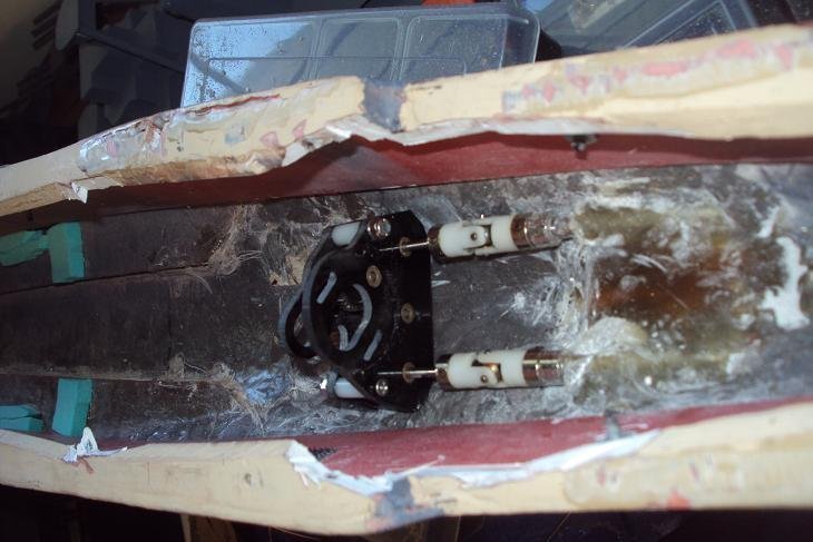

    Dec 30, 2006
    1,537
    HeHeHeHeHe :p Lined up perfectly. Almost no bend in the U-joints at all. I did have to modify the mount to lower it into the hull and get it even to the shafts, but, it was worth it. Got excited here. Was wondering about clearance and the dark resin spot was where the servo was before... looked like it would fit back in the same place. :):):)
