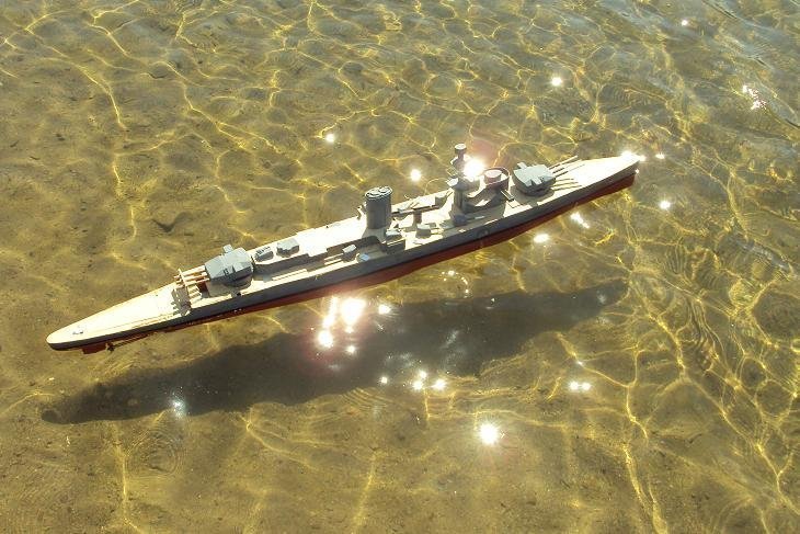

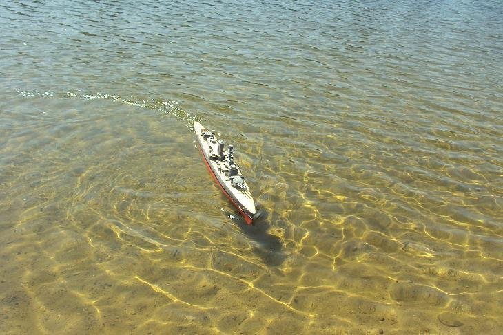

    Off like a rocket and performed beautifully! Nice classic shot under power and the sweet shadow on the sand underneath. Wind was a little higher than I woul dhave prefered, but, the ship handled it nicely. As with the quick test last night, this morning's run had spectators. Asking questions... it felt good to promote once again. Just gotta work out the bugs now.

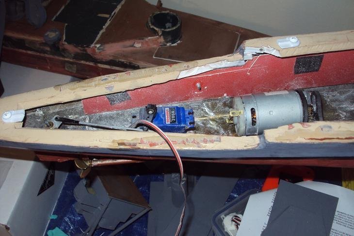

    Hiya all. Had a great trip to Halifax. Will be going again in a few weeks. Picked up some parts, had a great visit with Capt. Mackinnon. When I got home began thinking about the work to GS. Took everything you see here apart in about twenty minutes, greased the shafts and rudder post and put it all back together. Also Gooped in the moter mount. Letting it dry over night. Will go over the hull, and need to put some bondo and touch up paint around the shafts. Once that is done and I am happy with the back end of the boat I am going to make a new single hatch which will extend to the aft turret. This will be sealed with paint and some bondo. Should I need access for any reason I can open it back up and seal it again. Should make things fairly watertight. Also will be installing a pump (hurray) tomorrow, and sealing the radio box semi-permanently. Whew. Then another shakedown cruise on Thursday. :cool: I will keep you all posted.
    Hey Craig great work so far. For the quarterdeck I would use clear silicone and just put a thin bid along the edge, place your hatch on it and wipe off the excess(damp finger in latex glove and just smear over the edges. This way if you need to remove the hatch you can easily slice through it with your exacto blade and pry it loose if you need access. I had sealed Yamato's small access hatch with bondo before but when you need to get in it's a pain and makes a mess. I currently have it siliconed and it will be easier to pry off if I need emerg access.

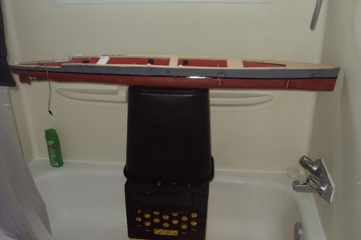

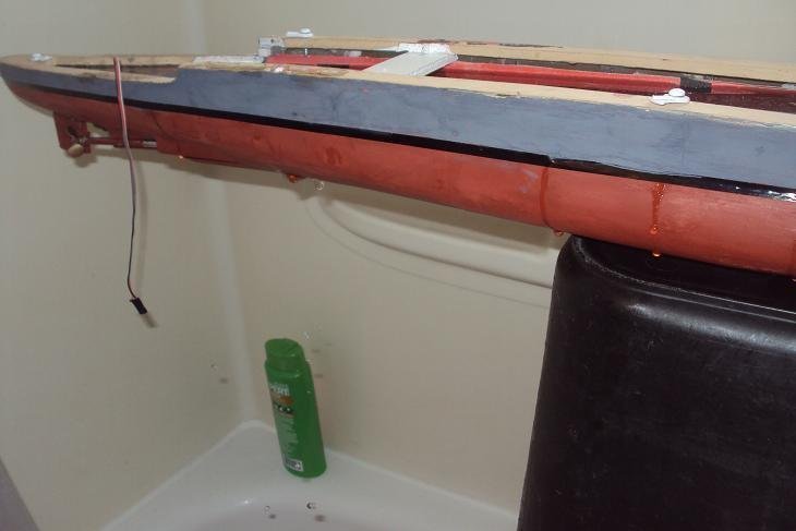

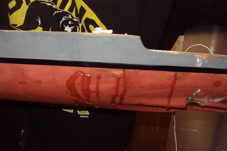

    Alrighty. tonight's update on Jack Sparrow's GS. Well. How does one find those silly little leaks? Here is an unorthodox way I found amusing today! Couple of milk crates with a garbage can and a tub. All we need now is water! Never said I play by the rules... just want results! :p
  12. Craig
    Craig Active Member
    Dec 30, 2006
    1,537

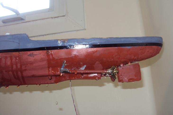

    Hello my pretty! Here are a few droplets. Nothing at all from the shafts or rudder post. Looks like the grease held up nicely. Hmmmmm. Couple of spots here.

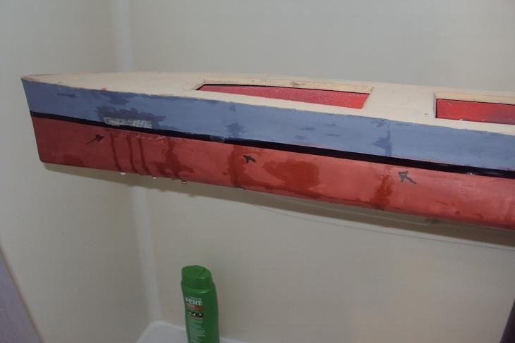

    Looks like Graf is crying.... it's ok. you will soon be a nasty little beast chewing up allied balsa. Although I still have not found anything major....

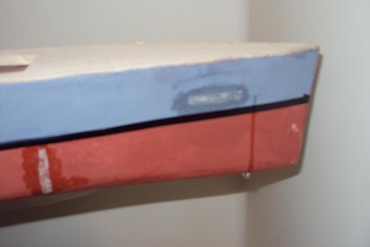

    Ahoy Matey! Shiver me Timbers! Yikes! What the :cry:o_O Looks like we found a weak spot on the port side. Wow. repairs needed for sure. What ya think? lol Nice dry shaft there....

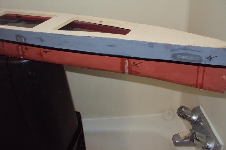

    Marked out the spots with a marker, were things were less than watertight.... well.... not so much at all.

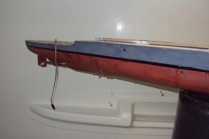

    Water still dripping and sploshing out of that cut. Looks like the culprit of the 11 minutes til hull was full has been found.

    From the looks of things, I may have a panel that needs to be replaced altogether. Lot of water seeping through.

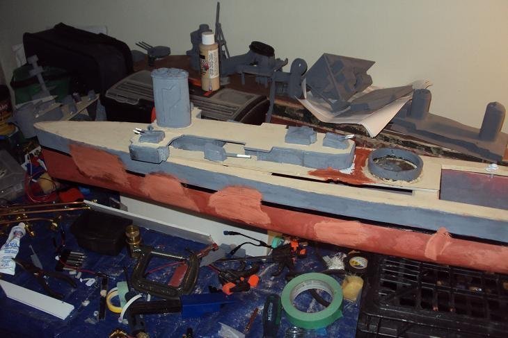

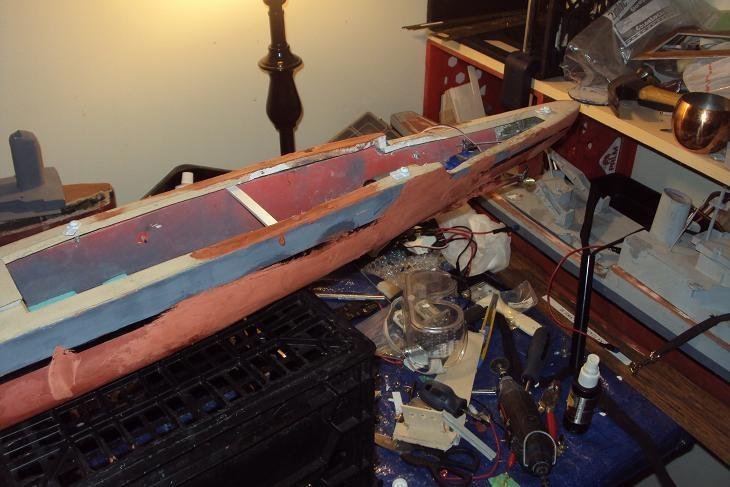

    After patching the with silkspan and sigment (forgot to take some beauty shots) I put a fine coat of bondo over the patchs. I will use fine grate sandpaper to smooth it all out and make it look pretty. The boat feels about a pound heavier, and I get the sense the work was appreciated. I also have the new hatch set up with bondo and CA. This will always be a little soft I fear, but, a more permanent solution will happen over the winter. For now it will have to do.

    Here is a picture of the new support brace that will be under the newly formed hatch. Also the patch job of the cut. It was actually through three panels. Ouch!
