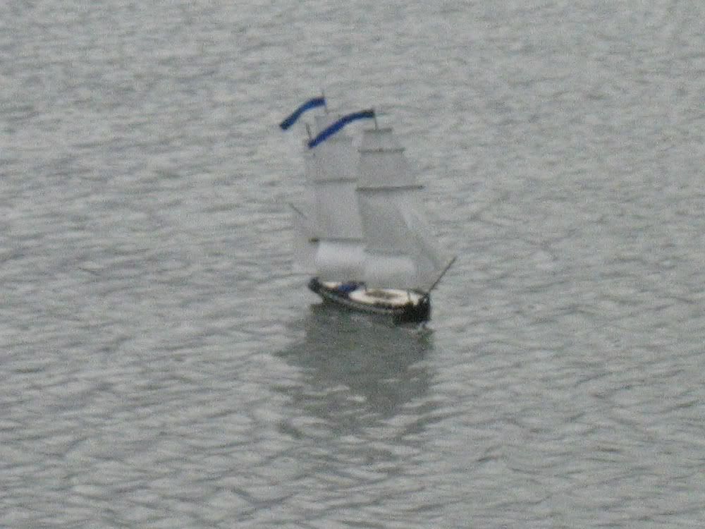

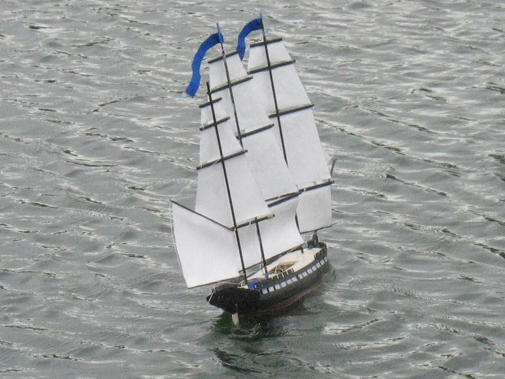

    Work finished early today so I went on a sailing spree :) Since I had more time, I visited a new pond today in search of better winds. The new pond worked out great! I had so much fun I sailed until the transmitter battery ran out o_O I also dropped my camera in the water :crying: ran over a fish ;) and ALMOST circumnavigated the entire pond :laugh:
    The new pond is called Elles pond in the Los Gatos Creek Park, in Campbell, California. It's a semi-rectangular pond roughly 300m by 400m with the long direction running north-south, and hiking trails all around. Winds blow mostly from the north, sometimes shifting to come from the east. I don't know how to estimate wind speeds, but I would describe it as topgallant weather. I started off with courses and topsails, but soon added more sails. I debated adding just the topgallants, but decided I wanted some pictures with the royals set and for the most part it worked out great. I launched from the northeast corner, and mostly sailed around there for a half hour while I took pictures. There was lots of tacking and gybing, chasing off a couple of piratical geese, and generally doing all those things that model square-riggers do. I soon discovered why sitting on a sloped shore while trying to tack AND take pictures is a bad idea. Moby Duck had been beating upwind for a bit and I wanted a photo of her partway through tacking. I missed stays then fumbled the camera while trying to recover. It slid down the embankment, then dropped about a meter onto the shore and bounced into the water. My ship went "hands-off" while I skidded after the camera, and stayed like that for a minute while I popped out the batteries and memory card. RIP, good old Canon A-610. You were a good camera in your time. Survived two sinkings and a cannonball, but this time it was too late. I think my next camera will have "waterproof and shockproof" as the #1 requirement.
    After the disaster with the camera, I was no longer limited to sitting down on the shore. So I set myself the goal of circumnavigating the pond. I knew I could tack and gybe and the Duck sails upwind remarkably well, as long as there is a wind to sail against. The downwind leg of the voyage went quite well. I zig-zagged south along the eastern shore, broad reaching to see how fast I could go. It was most impressive: I estimate that at full power, the duck could match or possibly even catch many of the battleships in the Western Warship Combat Club. That is, of course, on a beam reach with a stiff breeze blowing. Most of the time, though, even my sluggardly old dreadnought SMS Viribus Unitis could get away by pointing upwind. At one point Moby Duck suddenly jerked to a halt, then something silvery splashed right next to the ship and darted away into the depths. I can only assume that I ran into a fish, and the fish protested. The wind got stronger the further down I went, so about 3/4 of the way down I pulled her into a sheltered bay and lowered the royals and topgallants. I then set out on the southern leg of the journey.
    The wind picked up so much during the southern leg that I could only gybe, and I did have to sail around several fishermen on a pier and avoid their lines, but soon the west shore was in sight and it was time to point into the wind. I discovered that in heavy winds, two jibs is too much, and I had a lot of trouble keeping her bow into the wind. After a few minutes of suffering, I pulled her ashore again and took down the inner jib (what do you call them when there's only two jibs instead of three?) and things went much better. I got a good 75 meters upwind when it started to die. I headed ashore to set topgallants, but the wind completely died during the process. I knew the park was going to close but I didn't know when, so after waiting a bit for the wind I started the long hike back to the car. I was almost to the north shore again when the wind suddenly reappeared. Tired of carrying my ship, I finished setting the gallants and sent her eastward. There were fishermen at intervals along the north shore, so I had to keep about 15 to 25 meters off shore to avoid getting hit by "cannonballs" or snared in fishing line. The wind shifted to blowing from the northeast, so heading eastward was a difficult task. I got about 100 meters when the wind died, leaving me becalmed. Waves were pushing Moby Duck away from me and out to the middle of the pond, and I was expecting the park ranger to come by at any time to lock the gates to the park. I resorted to wiggling the rudder back and forth, fish-tailing the ship around to try and get ashore. By this time it was starting to get dark, then I looked down and noticed my transmitter's analog power gauge reading 60%, far below the red line and dropping fast. Fortunately right at that moment a tiny breath of wind came from the east and pushed the Duck to shore before vanishing again. I collected my ship and powered her off just as the power gauge passed 30%, then marched back to my car singing "safe and sound and home at last; let the waters roar, Jack!"
    Afterwards, I stopped by the hobby shop for some paint and a few other parts, and a hardware store for a folding fireplace thingie that I will turn into a boat stand. Then it was back home again to "Drunken Sailor", "Jamestown Homeward Bound", and other sea chanties.

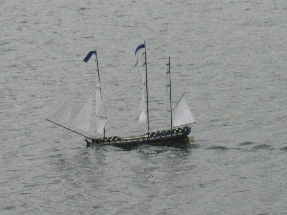

    Just to give you an idea what I'm talking about, here is an example of Moby Duck getting driven under by a gust while running.

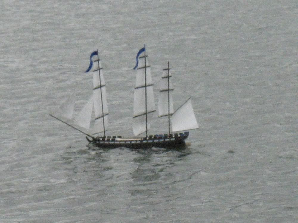

    omg GUST! notice how little speed she has when buried.

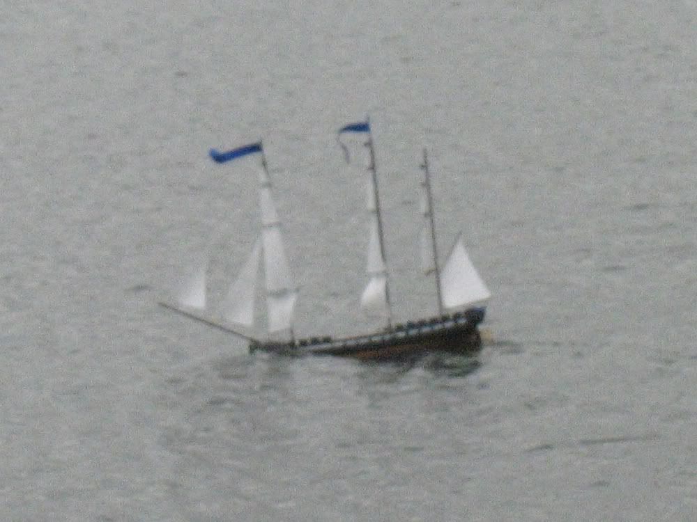

    About 15 seconds liater. With the gust dying, her bow lifts back up. Notice the difference in speed now that she's not buried.

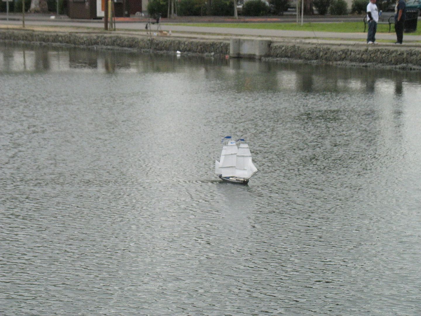

    And the gust is completely past. Still slightly down in the bow due to wind, but no longer in real danger:
    Over time I have been shifting ballast aft. Today I replaced a couple 6oz weights with 8oz weights, bringing total ballast up to 2lbs8oz and moving aft. Anyway, now you know what to look for, Tugboat. If your ship does this too, we really may want to experiment with bow-mounted hydrofoils. I don't think adding wings to the main keel will help. If we do need to do something, it would work best all the way in the bow.
