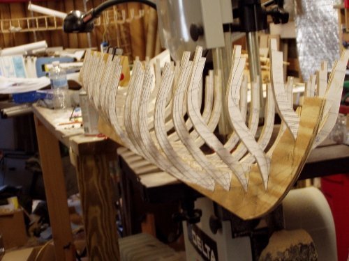

    The ribs are cut out of the paper, and glued to the plywood. The keel is laid out. And, courtesy of a particularly nasty sinus infection combined with a black mold crisis at work that has the clinic shut down for the rest of the week, I have the week off to cut wood and epoxy. As long as the antibiotics and anti-cough crap keep working, I should have Minerva's ribs, deck, and masts attached to a keel before the weekend!

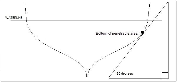

    Side note, I read Carl's V0.1 rules, I look forward to testing them! I am building largely to the construction specifications in those rules; When you say '60 degrees down', do you mean 60 degrees from vertical or horizontal?

    Perhaps it would help if I shamelessly rip off the diagram from the WWCC rulebook:
    I have a feeling there will be many more diagrams that I will need to shamelessly rip off before the Age of Sail rulebook is complete :whistling:
    Ahh... I'm safe, then, I laid out the ribs to a 45-degree standard, which is a bit lower towards the keel. No problem! :) I can always add hard area later if I want. Thanks for the shamelessly ripped drawing :)

    Hmm... 45 degrees might not be too bad. 60 degrees gets rough when you're trying to bend 1/8" balsa, but we're using 1/32" and that's a whole lot nicer.
    Yeah, with 1/32" it's not too bad, IRCWCC and MWCI both use 45 degrees. I went with it because I knew we'd be heeling, and if it turned out that we went with 60 degrees, I'd still be legal :)

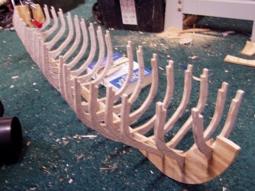

    Wow! That bandsaw sure does cut a lot of wood! I've got the ribs cut and fitted to the keel. To paraphrase Han Solo... sometimes I even amaze myself! ;) It's an awesome looking thing; just looking at the ribs on the keel, I can see masts and sails hovering there as a ghost image :)
    Young master Carl will NOT be the only sailing captain on the forums for long! I go now with the camera to capture photographic evidence of my deeds, to be posted forthwith!

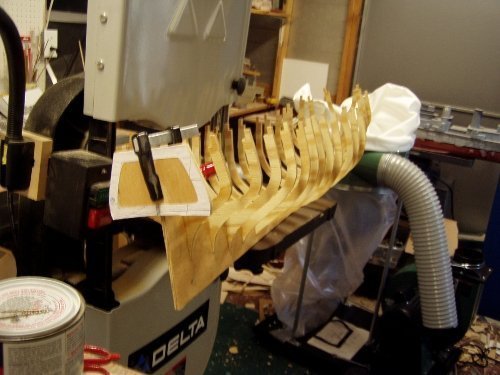

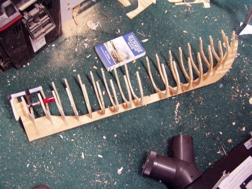

    Here are the early photos of HMS Minerva in drydock, or at least sitting on the new bandsaw... I've got the backlight frame clamped to the stern temporarily to figure out where I want it. Once I have that figured out, I'll cut out the center of it. I will likely put in a 1/8" wide vertical member in the center of the backlight to reinforce the balsa. Look at the size of that skeg! Ye GODS, man, it's huge!
    and from the bow... I'm still playing with this part, I'll probably move the forwardmost 3 frames down a smidge, as it looks far too much like a north sea bow, and not as flat as the plans do. It's easy to fix at this point.
    and a side view for you... I threw in a random book for scale purposes :) Seriously, though the Y-shaped black thing is a 4" diameter y-connector. Or, the book is 5" wide and 7" tall.

    Rar. It's almost 6PM, and among my other duties today, I got the caprail mostly done. The center isn't cut out, yet, but it will be soon. I wanted to take a pic of Minerva while she still looks like she's got a deck, and I wanted to double-check my mast locations before I cut the caprail (it will be one large caprail, with athwartships reinforcement around where the masts will fit). The masts are going to be removable for ease of transport in a Toyota Avalon's back seat. The Avalon is my main commuting car, and since my commute to my new job will take me within 10 minutes of the battle/sailing pond, it would be nice to be able to take the ship to work so I can steal an hour here and there on the way home for sailing practice... I have a funny feeling that a lot of whether one hits the target in this game will be determined by sailing skill, so an hour a week would be a good thing. Might even be fun in its own right, ja?

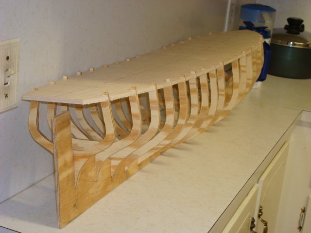

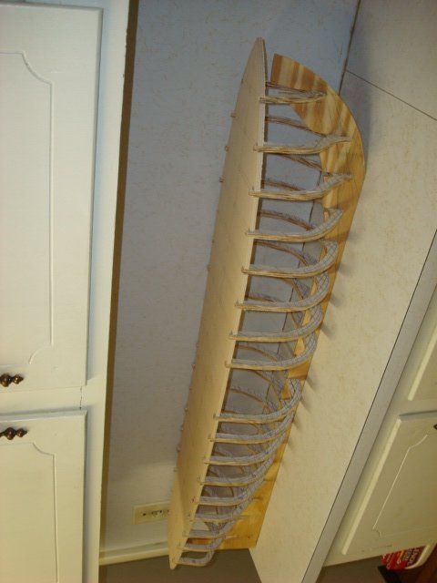

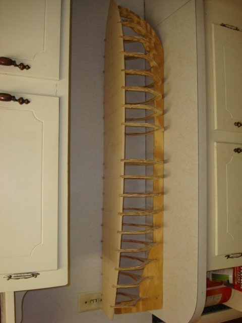

    I didn't get anything else done, as my wife had to work late and I had to go in because I don't like her there alone at 8 at night. Call me old-fashioned. Anyhow, when we got home, the camera was charged and I got some pics of Minerva with the unfinished caprail fitted. At this point, it's all joinery holding it together, she's remarkably solid for no glue involved :) Sternlight windows aren't in because there's no glue involved yet :)
    quarter-ish view: The bow will get prettied up as I progress... I like to leave that open so the form of the bow can find itself :)
    And... side view. Frame 9 is hiding in the shop somewheres...
    Tomorrow I will install frame 9, and cut the subdeck and deck. Masts will be test-fitted; stout oak dowels have been procured in 3 diameters for making the masts. I plan to epoxy a quarter under the mainmast before it is stepped. (Epoxy so the quarter will stay there when the masts are unstepped for travel). Time permitting, I bought some 1/32 bass to plank the solid parts. So that can be put on, and prepped for a layer of epoxy and 'glass!

    Looks good, Tugboat. I hope you find the missing rib. Are you planning multi-piece masts, or single-piece masts? And have you given any thought to the joint between yards and masts? I wasn't entirely satisfied with the screw eye method. Certainly not until I find a better way to easily mount and dismount sails.
