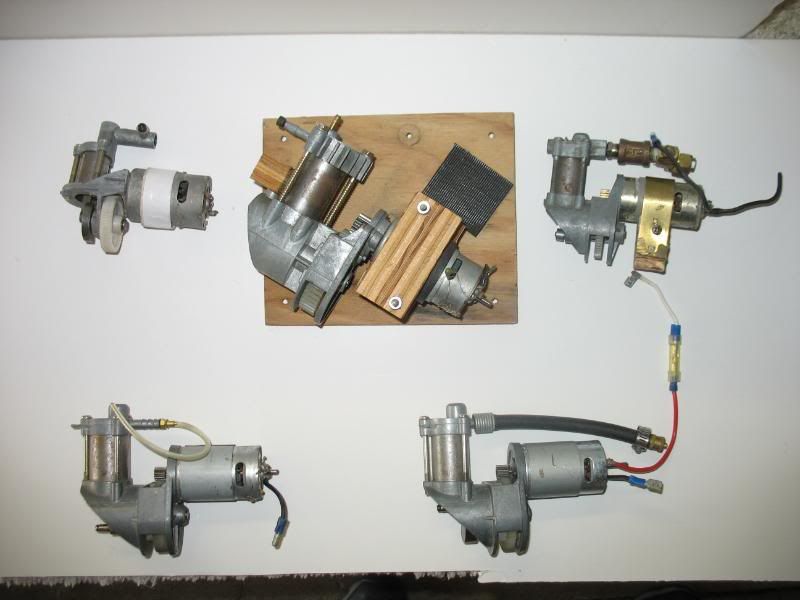

    A collection of various air compressors:

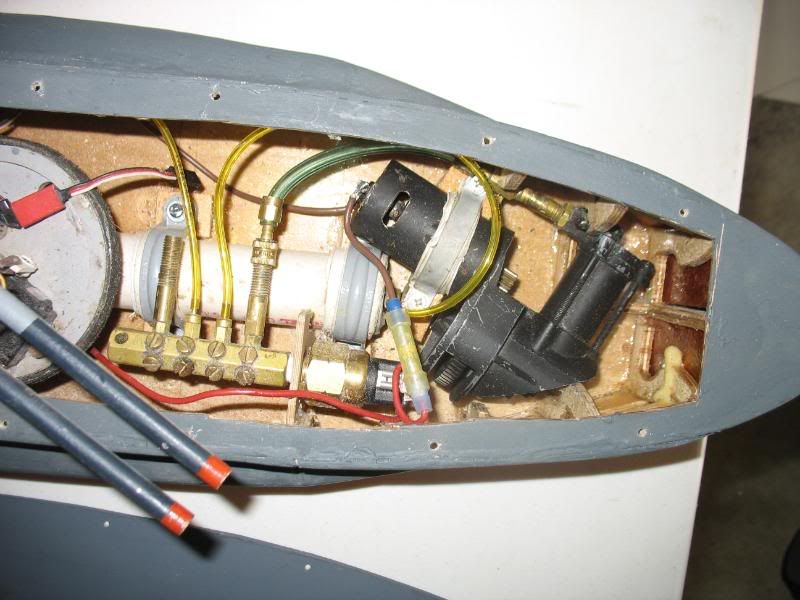

    Air Compressor, sprayed black, in the bow of a Monitor:

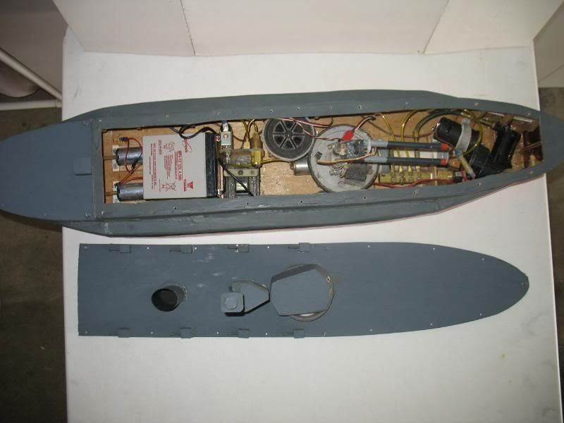

    The entire ship:

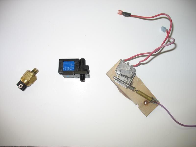

    A collection of various pressure shut-off switches (air compressor's equivalent of a regulator):

    You can buy a cheap tire inflator 12v air compressor at bike stores, hardware stores, and often even walmart. All you need to do is rip the compressor out of the case, wire in a pressure-shutoff device, and find a way to deal with the noise and vibration. Air compressors aren't exactly silent.

    For a cutoff switch, I use the Dwyer Series A-2 subminiature pressure switch:
    http://www.dwyer-inst.com.au/htdocs/pressure/SeriesA2Price.cfm
    It works very well, is compact, and doesn't seem to mind sinking too much. You can adjust it from 50-150 PSI, so you cannot physically exceed club safety settings, and it handles sufficient current to not melt when running a compressor.
