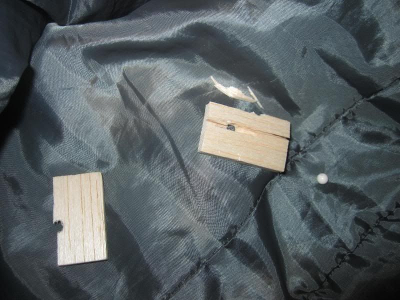

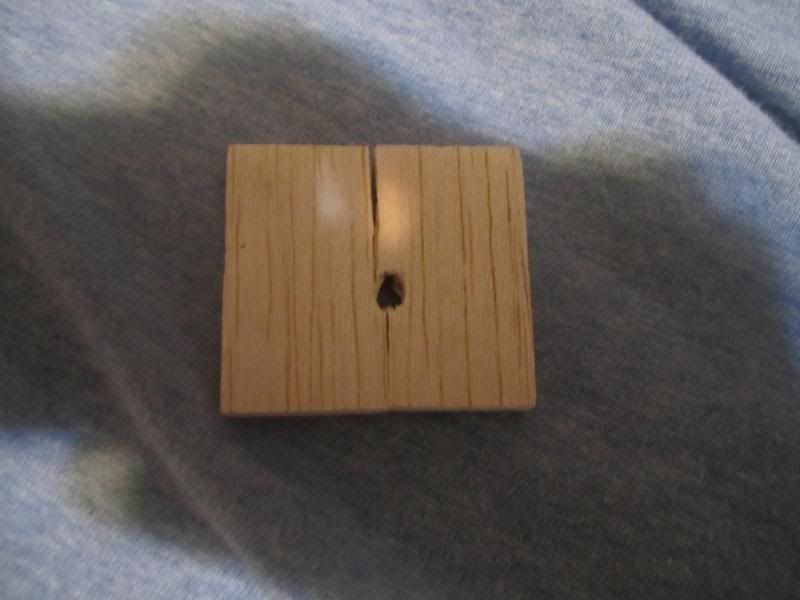

    Found some 1/4" balsa to use as a test.
    The pistol shoots around 320fps, with the light bb.
    1st shot, Point blank.
    2nd shot, 10FT:
    Of course this is with no paint or the silkspan. However this is still a low powered gun. There is potenial here.
    The Fixed slide pistols usually go for around $40 and up from there. If they were used, you could techinicly get rid of the entire CO2 setup, and just use the pistols magazine and internal gas supply. Servo to pull the trigger.
