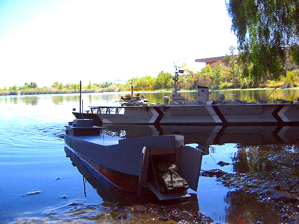

    Yes, the WWCC had a functional LST that could land a small tank on the shore, built in 2005. It was even used during the campaign battle that year. Unfortunately, Rob had not tweaked the speed in, and it was way over speed, so the Axis complained mightily. It still sailed, and no axis vessel was able to catch it. It pulled up to the beach, but the mechanism jammed, and the tank failed to come out. It had successfully demonstrated the ability earlier in the day, so it just choked under pressure, I guess. Regardless of why the mechanism failed, the mission was a failure.
    Landing beach
    Doors open, ramp down
    Tank on the beach
    After the battle, pretty much everyone agreed that although it was very cool, it was not suitable to form a whole combat scenario around. The biggest problem was that it added too much complexity to the game without adding much to the fun-factor. Before the battle, there had been discussion about shore defense guns, dock targets, tank traps on the beach, and other stuff. Rob was particularly worried about someone shooting the tank. It was a real mess beforehand. Everyone loved to see the clam shell doors open, the winch lower the ramp, and the tank roll out. It was an amazing accomplishment, but it was better suited for model shows and maneuvering events than battle.

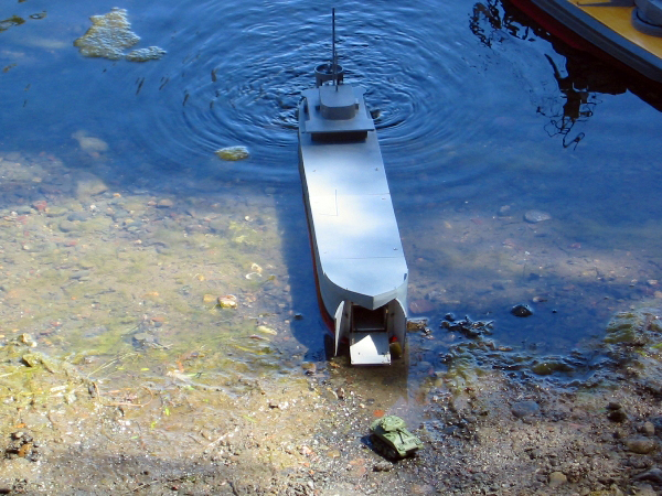

    Once the LST hit the beach, the clamshell doors opened as designed, the ramp came down, and the tank rolled down the ramp and onto the beach:
    The tank rolled up the beach, onto a scale road, and climbed to the top of a scale hill to a flag pole. The tank drove into the flag pole, and "captured it." At that point, the battle was over, and the Allies had won. That was according to the clearly-defined scenario rules. That was controversy #2: winning an RC Warship Combat battle with an RC tank. That controversy and the resulting bad blood, Axis vs Allies, is what caused me to retire the LST. Nobody wanted to revisit the bad blood. I still have the LST and tank, and they still work. But our hobby is about warship combat. When we start messing with it, and begin to simulate combat, rather than "Deal in Steel," the game suffers.

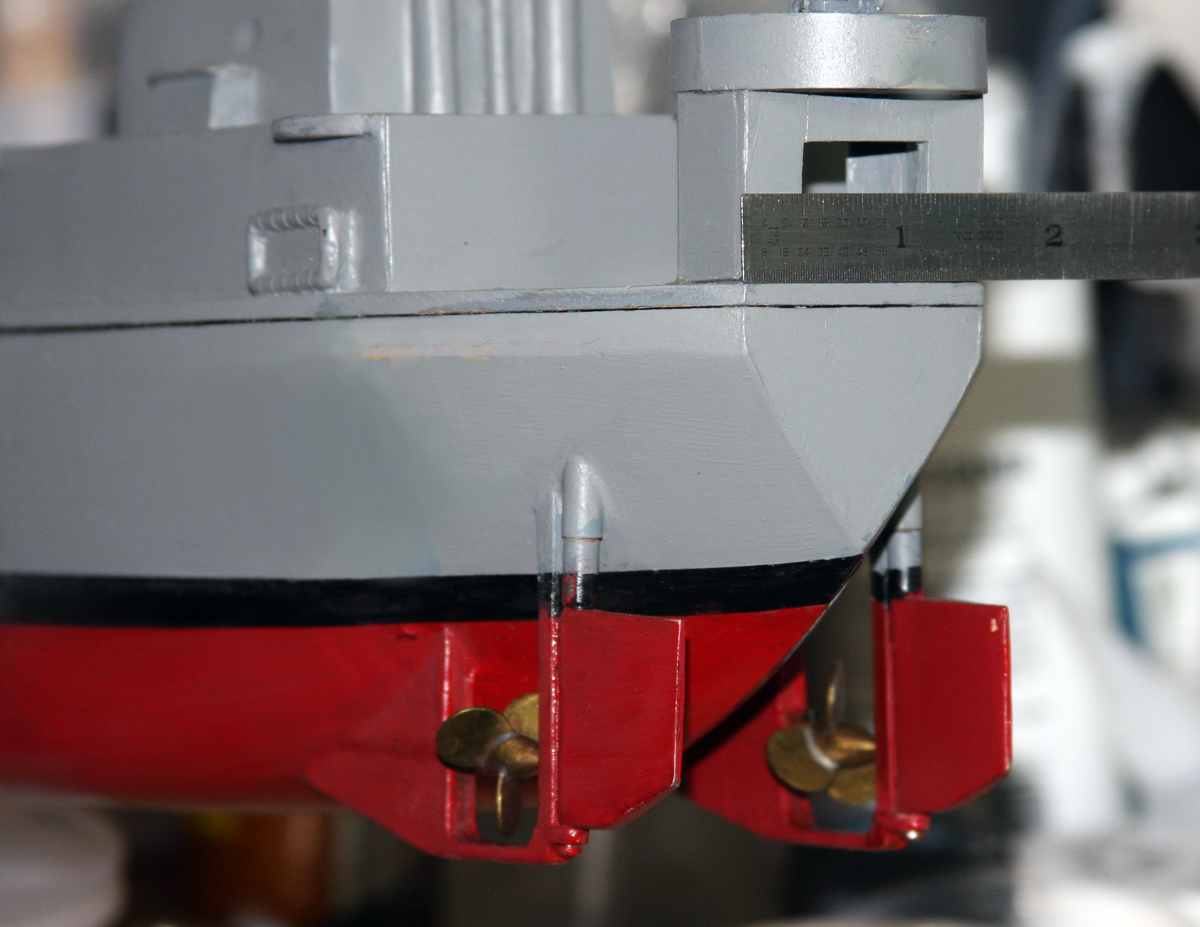

    I was hoping that there might be an RC shortcut that I could use to make the whole thing work, but as it turned out, due to 1:144 space limitations, only an actual 1:144 scale solution was possible. Not only that, the rudders and props of the LST have to be built scale as well, or the ship can't maneuver, and it can't run up on the beach:

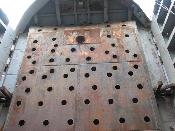

    The outer, clamshell doors do not keep the water out of the hull. That seems pretty obvious when you look at how beat up many of those doors look in old photos. The clamshell doors are there to prevent the full force of the sea from breaking against the ramp. It's the ramp, pulled tight against a rubber seal (tested at 150 PSI), that keeps the tank deck watertight:
    The LST runs up on the beach, or as close as possible, and a rack and pinion gear (see above) on each side of the ramp pushes the clamshell doors open, and the ramp is lowered down by a chain. My LST works exactly the same way. I had to make my own rack and pinion gears to make it work, and find a way to keep the ramp pulled tightly against the miniature rubber seal to maintain watertight integrity.
