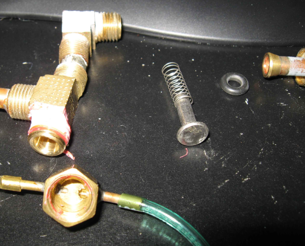

    Doesn't the 90 degree at head of barrel cause issues. Back in the day I made my barrels from stainless. First cut to length, height plus barrel length. Then melted bismith(?) an poured down barrel. When hardened barrel was bent using tubing bender. The barrel was then put in boiling water to melt bismuth (about 100 degree melting point) go air to clean. Using bismuth in barrel prevents linking. Nice smooth barrel.
  4. GregMcFadden
    Both methods work fine. if the L fitting is too soft eventually a dimple will form and prevent it from operating properly but they shoot fine. With the bent tube you must use stainless or eventually the ball will wear into the copper fitting. Both options have upsides and downsides but both work
