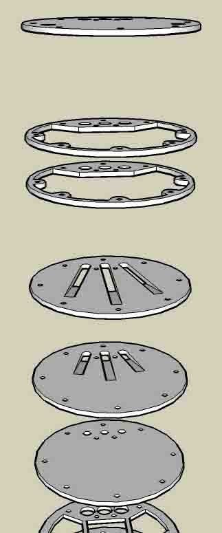

    one thing that allows tighter spaced O-ring breeches is to simply place the O-rings in two appropriately sized pockets in a single block, compress with a single fastener between the o-rings. has the added effect of balancing the load better, and seemed to make twins less fussy

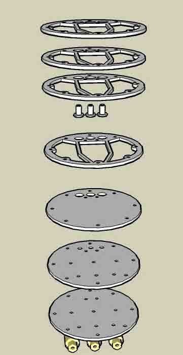

    Okay some more pictures.
    This is of the redesigned variation 2 cannon with internal accumulator. I increased the number of holding bolts to make sure the accumulator doesn't leak. I also added more depth to the accumulator so that each cannon has over 1 cu. in. of gas to use. I also combined the feed plates to make 2 1/8" plates so that now all plates are 1/8". Hopefully this will help same money as one would have to file a slant in the feed plates anyway. The pictured plate set is configured to use 3 MAV-2 vavles which have 6.8 scfm @ 100 psi and so I figure roughly 8ish at 150 psi. This will work so long as I can figure out the o-ring breach assembly. Speaking of the breach assembly, I'm trying to use Greg's hybrid design as a start point. I'd like for the assembly to fit beneath a scale turret, but...we shall see.
    [​IMG] [​IMG]
    Hopefully I can have a workable breach done before the end of next week as I am headed out on vacation and I'm also working on finishing a convoy so that I'll actually have something to play with while I'm down in the south pacific.
    Just noticed that I hadn't yet drawn in the manifold on the plate next to the bottom.
